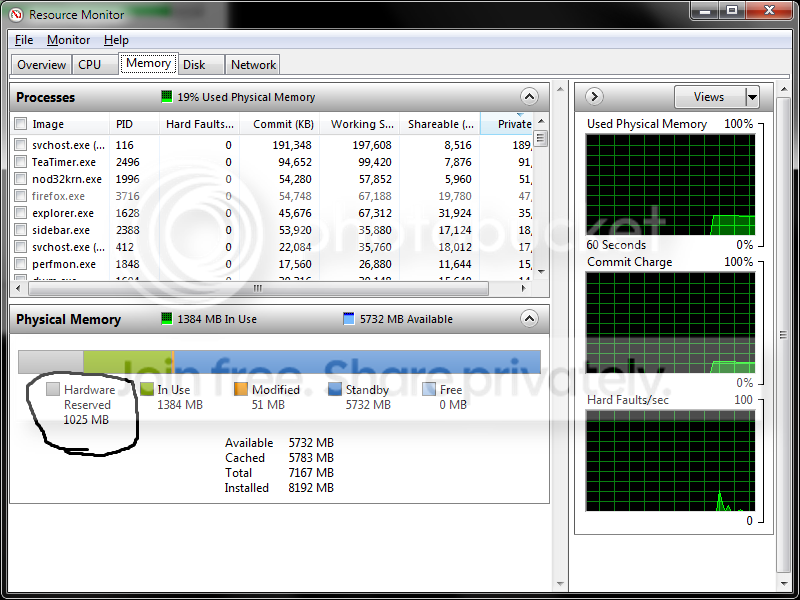

Hello all,
First post and I thought of you guys first since I'm having a very odd issue.
First off so I don't get this! I'm on Windows 7 Professional x64, so it isn't limiting my RAM for having x86!
I have 8GB (4x 2GB) sticks of RAM installed, and it recognizes this, but it still only shows that 7GB are available for use. I checked it out under performance monitor and for some reason 1GB of it is going to my hardware.
Now I have 2 video cards each with 512 MB of RAM on them.. for some reason I'm guessing it's not recognizing those.
Any idea what the heck is going on in my system? Thanks in advance!

Check your BIOS for an entry that will relocate your video ram (goes by different names). Some motherboards can't do it though.
By default the video ram does sit in the lower 4 gig. Having a 64 system means you can have more than 4 gig of ram installed, but doesn't get you around the fact that your hardware may [edit]still need to use[/edit] still block some of it.
Even if you can relocate your video memory above the 4 gig line, if you have 8 gig in your machine it may still show up as a hole... again, motherboard/BIOS dependant.
BTW that bar graph doesn't give you the relative locations of those memory usages, merely the amounts in use... The hardware hole is not at the begining of the ram it's most likely on the 3-4 gig. mark

I understand that it's relocating the video RAM, but I'm still missing a GB of RAM somewhere.
I have 1GB on my video cards combined, then 8 GB installed. Why would the video cards be taking away from the 8GB? Wouldn't it be adding to make it 9 instead?
Don't worry, although your cards have 512mb each,
Windows reserves another gig for them in case it's needed,
The more mem you have, the more will be reserved.

Depending on the motherboard, sometimes the relocation ofthe video ram only gets pushed up to the 5th gig :/
Now since you obviously have a 64 bit ready MB that cn take more than 4G of ram... It wold seem hard to believe that they were only relocating the video ream from the 4th gig of ram to the 5th, it should be moved to the 9th, 13th or maybe the 200th, whatever was just beyond the max ram the MB wwould accept. :)
At that point I run out of steam about the limitations the BIOS might have with where it can move the video ram to attempt to get it off main ram space though...

Yeah I checked my BIOS and no memory remapping for me, so I'm stuck! Anyway, thank you all for the help, I'm guessing this is solved then!
In some BIOS's it is named different, like memory hole...
Can't imagine your mainboard supporting 8gb but not remapping.
Look again.

Never mind, I found this in your board's manual:
Due to the chipset resource deployment, the system density will only be
detected up to 7+GB (not full 8GB) when each DIMM is installed with a 2GB
memory module.
