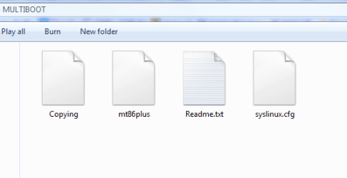

I boot from the USB drive abd I get a message that says Missing Operating System. What am I missing?

Very odd, open the USB stick, it should have the same files as in the snip.

I used another USB stick and it worked! I don't know why, but it did. Thanks

Great, I'm happy you got it to work. The 1st USB stick has some sort of issue it seems.
