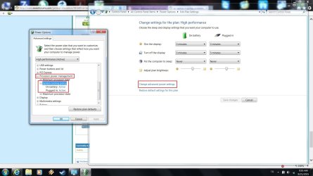

If it is running cooler, I wonder if cooling policy was changed in your previous plan. Mind checking the previous plan's settings?
Cooling pad will help for sure, I don't have experience with a vacuum fan.

re: laptop is giving problems after it heats up
System cooling policy
On battery: Passive
Plugged in: Active
I rarely ever take the laptop anywhere. 90% of the time the laptop stays plugged in and sitting on the desk. I had an older Toshiba Satellite M60 laptop OS XP Pro that I used to use for my ham radio digital sound card prog's that sat so long plugged in that the battery leaked a black tarry substance all over the bottom of the laptop, on the table and under the cover were the memory sticks and the wifi board are. I salvaged what I could and tosted the rest in the garbage. This is kind of like when I used to fix cb radios for a living back when cb's were the craze. I get ppl coming in with there rigs saying there radio transmissions were going out garbled and bothering the nighbors tv's and radios. I open the radio up and find that the transmit bios voltage was cranked way up and the final transistors blazing hot because they were over the top of the linear slope and flat topping which causes splattering all over the band. The cb operators are only allowed to transmit a max of 5 watts. By cranking up the bios voltage they can get it up to about 8 watts of power out. But there is a price to pay for doing that. Changing the power plain reminded me of the cb bit. Same general thing with cranking up the juice on the cpu.

No there weren't any problems while recording the stats. I just changed the Power Plan to High Performance and the laptop is running a bit cooler now. I can past in the High Performance settings in if you need to see them. Also I have picked out 2 things on Ebay that I am going to get when I get my SSDI check on Oct 1st. A USB LED Light 2 Fan 9"-17" Laptop Notebook cooling pad adjustable cooler and a mini vacuum USB cooler air extracting cooling fan for pc laptop. Between the 2 they should keep the laptop at a safe temperature. What do you think
Did you notice the problems happen while recording those stats? Run Prime95 while having HWINfo open.
By the way your Specs say: CPU dual core 2.1 gb each
But HWInfo only show a max of 1.73GHz, maybe it was not even run at 100%.
