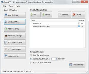

This is data from EasyBCD. I haven't changed anything yet. I find it disturbing that EasyBCD thinks there are only two entries.
There probably only are 2 real BCDs.
This is what this whole thread is about - removing one of the redundant entries I am presented with at boot time :)
Windows 7 Ultimate N

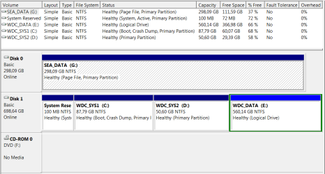

Easy shows Win7 on F partition which isn't shown in your Disk Management screenshot.
If you're running Easy from Ultimate on C, then on Edit Boot Menu delete the incorrect listing for Win7 on F and add it by its correct name and drive letter on the Add New Entry tab, reboot.
If this fails to remove the ghost entry then run Startup Repair - Run 3 Separate Times
on Ultimate to rewrite the System boot files correctly. You can later edit out any "Recovered" label in Easy Edit tab.
Thanks to both of you guys, I managed to clean up the boot options by using EasyBCD. The ghost entry is now gone. When I used EasyBCD to edit all this, I ended up with a non-bootable system, but using my Win7 Ultimate installation disk (on a USB stick), I came through by letting it repair the system, followed by a rename of entries in EasyBCD.

Post back a screenshot of your Disk Mgmt drive map and listings, using the Snipping Tool in Start menu.
No more problems so far
It shows the Paging file correctly moved back to C which is booted. Is D the other OS? Does it boot OK?
Yes and yes, Greg :) Everything is OK now, thanks again.
