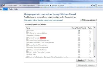

Uninstalling Norton=Good idea. I wouldn't reinstall Norton at all. You can use MSE and Windows Firewall.
That said, when you state that you've disabled firewalls, does this include Windows Firewall (in Control Panel)? If so, I'd re-enable it, as you are leaving yourself unprotected.
You should, however, check that WF is allowing RD to communicate through WF, as per screenshot:
