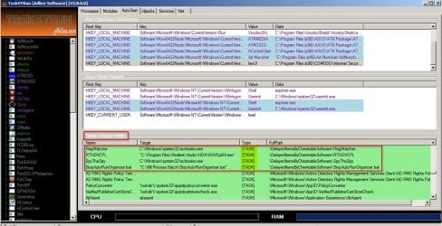

TaskSTRun crashed when run after installation. AutoRun installed successfully. I found some yellow lines indicating missing files; I deleted them all. I also found entries for OneNote, but they are not related to delayed startup at all. Just OneNote add-in entries in the registry.
The OneNote problem remains, but it appears TaskSTRun crashed because Task Scheduler, when run, shows error messages relating to corrupted task images:
RE: Yellow Lines. You should not delete anything because AutoRuns cannot parse (read) all files and may report missing files when in fact files and paths are valid. This needs manual confirmation by navigation to the location of the file and you might need to view hidden files to confirm.
Not sure if that's why it crashed. You should right click the executable and choose "Run as administrator" from the context menu. Same goes for AutoRuns. Plus check if any security software might affect the program.

After the repair, I ran TaskSTRun again. Results are different in that there is no crash, but there is an unhandled exception:
If I continue, this is the result:
Nothing is displayed.

Wow, lotta information, extends beyond even my dual monitors! No OneNote entry, though.

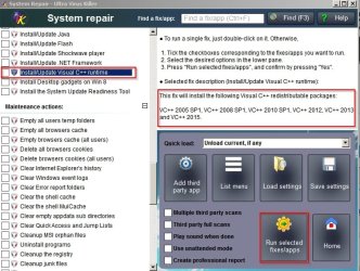

Okay I think you are either missing or need to update a missing Visual C++ redistributable package. If I remember correctly I've seen those errors on my own machine.
EDIT: Corrected image.
The easy way to update is grab a copy of UVK and run it (right click and run as admin)
On the System Repair tab use the following fix:
A reboot will be needed. If that doesn't help you might need to uninstall all versions of VC++ and reinstall them.
It wouldn't hurt to launch the Autoruns tab in UVK and see what shows up.
Anyway at least you've found out that there's no scheduled task causing the problem.
This solved the problem. TaskSTRun runs and displays properly. Forgot to run UVK as administrator and didn't reboot. Below are the affected dist. C++ files (dated 6/5/17):
