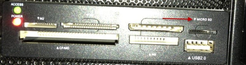

Just a heads up on the reader issue. I purchased a multi-card reader and it does read a Micro SD without an adaptor, see image;
SD's do have a limited life span and the problem for the OP may be the one he's trying to read has come to EOL. I do know that every micro card I have used has no lock.
