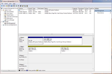

Here it is... as promised.
Same Letter drive but one has +600GB and the other + 300GB... although, on Explore, it shows as a single 1TB drive
Don't really know why one disk is Basic and the other Dynamic but really, those are things that I never seem to understand and as far as I am concerned, as long as this is working, I am ok with that. If it can be fix w/o major surgery, I am willing to attempt, otherwise, the rig will be leaving tomorrow so it will stay that way.

The drive should not be Dynamic unless it is two separate HD's.
So, if I were to make two partitions, would that be ok? I just don't want to run the risk of something happening to the Data while I do the transition to Basic and I have no where to move all the data, I have about 350GBs worth of Documents, clips, pictures & music.

Not two partitions. A Dynamic disk is meant to span a single partition across two or more separate HD's. Working with Basic and Dynamic Disks
But the problems we've seen have only been with a Dynamic OS drive, so you should be okay although any data which is not backed up is always at risk due to possible disk failure. Here is a free method to Sync, Backup and Store your Files to the Cloud with Skydrive - Windows 7 Forums
Once you've got your data safely backed up you can easily and non-destructively Convert a Dynamic Disk to a Basic Disk using Option 1, or Easeus Partition Master free installed version.
