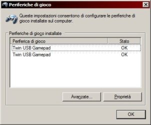

Hello, I'm playing RE5 and I have this problem, as I have a double joypad USB (two controllers connected to one usb plug like this images.jpg) bought for mistake, so I isolated the first one and use the second one (so in case it breaks, I can use the other one as backup).
If I start the game with keyboard input, it loads the savegame profile, but if I use the second joypad it doesn't (it asks me to choose "gamer profile" but when I click "Yes" it doesn't go anywhere, I can click yes endlessly or just "no" and proceed to game without saving options). I know it's because I use the second controller, because when I use the first one from the beginning it goes fine, here's the config.ini file content:

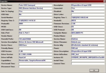

It could be the serial number to the USB device. This is one of those things where I'd have to be there at your computer to mess around with. If you run USBDeview, do you see two distinct serial numbers for these game pads or just one? I'm thinking since both were joined together one has a chip that has this serial number while the other does not. I think... It's possible the game is going by the unique serial number from the USB device. You could uninstall and reinstall all devices in USBDeview and reboot and see if that helps. I wouldn't uninstall the keyboard and mouse though. Sort the list by device type by clicking the column.
View any installed/connected USB device on your system

Thanks, I didn't know about that program, unfortunely on Windows it is shown as two joypads, but on usbdeview it is show as one device
I also noticed RE5 recognizes keyboard or the first joypad as main "profile":
- if I go through "Start Game" by using keyboard then use the second joypad, it loads the savegame correctly
- if I do that by using the second joypad, it doesn't load the savegame (bogus gamer profile prompt forcing to proceed without saving)
- if I do that by using the first joypad, it says "Control mode switched to joypad" then it loads the savegame correctly
I'm clueless, I guess the only way out of this is somebody who can release a patch or something like that, for non-steam versions (like Gold or something... I heard about "QOL" patch but it really wasn't my case as it didn't work).
