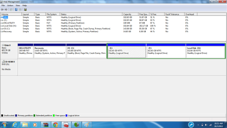

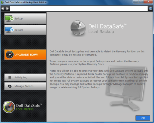

Hi.You see that I still have the recovery partition but dell datasafe can't recognise this.Is there a way for me to restore my n5110 laptop to it's factory settings with all apps and utilities that was pre-installed?Please help me... Few days back I mistakely changed the active partition to OS (C:) and then the computer won't boot!I then inserted the OS disc and used command prompt and set the recovery partition as active,which fixed the problem of not booting.But when I take the dell datasafe local backup it is not recognisig it.I also haven't created a system recovery media.
I have attached two screenshots (1.Disk management , 2.Dell datasafe local backup) with this post.Please help me.

To have successfully moved the System boot files to C then after moving the Active flag there you needed to run Startup Repair - Run 3 Separate Times. Since you didn't do this then the boot files were still on Recovery which is why it started up just by moving the Active flag back there. However for some reason Recovery doesn't want to run now.
Have you tried running Recovery from boot? Dell Restoring Your Computer´s Software to the Factory Settings
If this PC had Dell Recovery on the F8 Advanced Boot tools menu than you can try Dell Recovery Partition - restoring F8 link.
If it still won't run you can try adding Recovery to a Dual Boot menu using this method: Boot Recovery Partition using EasyBCD then run Recovery to see if it restores it's links.
It might however require ordering Recovery disks from Dell.
Or you can get the superior Clean Reinstall - Factory OEM Windows 7 without the factory bloatware, replace Recovery with your own external backup image of your customized clean reinstall. Backup Complete Computer - Create an Image Backup
I did try pressing the F8 key but nothing! Previously I had an option "Dell Factory Image Restore" but now it's no longer seen.And one more thing,previously the active partition wasn't C:\.
