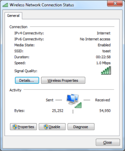

Around the house, my wireless connection is ridiculously slow where on previous occasions it was always fast. I have another laptop I'm running side-by-side with the my VAIO and its wireless performance is flawless, so I'm confident the router isn't the issue. My VAIO reports the signal quality at full bars, but the speed is usually only at 1 or 2 Mbps, whereas my other laptop always holds at 54 Mbps.
The connection itself is flaky. I get knocked off every 5-10 minutes. The only time there's any stability is if I'm 5-10 feet away from the router.
Any suggestions? Thanks.

Thanks! Unfortunately, resetting my router did nothing. I thought I solved the problem last night by editing my power plan. It seems that my wireless adapter was running on a power saving mode. After an adjustment, I thought I was in the clear when my connection was reporting speeds of 36 to 54 Mbps. However, it seems I'm back to square one this morning with an abysmal 1 to 2 Mbps. I really haven't a clue what's going on.

I'm not using a firewall or anti-virus application. It's 64-bit. The status window reports that IPv6 connectivity has "no Internet access." I don't believe I've turned off IPv6 support.
