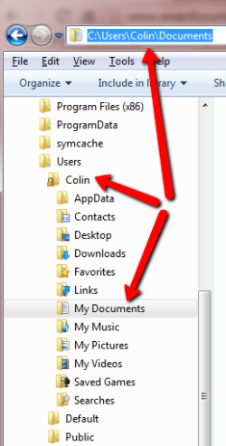

Mmm, I wonder if its the old "Library/junction point" problem.
C:\Users\Tim\My Documents is actually C:\Users\Tim\Documents...............try it yourself : browse to \Users\Tim\My Documents in Windows Explorer....now highlight it in the address bar of Windows Explorer.
Edit the path in robocopy to read C:\Users\Tim\Documents........does the error still occur?
