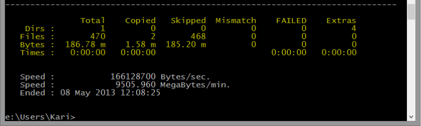

I created folders Test and Test2 on drive E:, copied some files over and under two years old and tested with command
robocopy E:\Test E:\Test2 /e /mov /minage:730
Works perfect. All files older than 730 are moved, copied to destination and deleted from source. I can only think of two possible causes for your issue:
  1. System considers files to be newer than 730 days old
  2. A syntax error in your command
Please run the command, take screenshot of the last part of summary (under the dotted line, highlighted in screenshot below) and post it here.

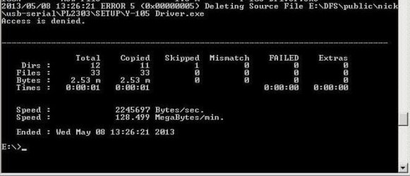

I have tried again but same result. It is just doing the copy and not deleting. I am using wind server 2008 R2. Does that make any difference?

It looks like may you have a permissions issue because your screen print shows "Access is denied".
Can you make sure you have enough free space and try to copy and delete one file to see if that works?

I did not get any errors. I can access all files but dont know why that message came up. Also I have tried moving 5 gb files and my disk space was 46gb. Even then it is copying all files but not deleting it from the source.
windows 7 Home premium 64 bit
OK.
With that answer I think you have some type of permissions problem because of the "Access is denied" error.
I'm no security (or any) expert, so my advice is wait for someone more knowledgeable to help with this.
It may be as simple as taking ownership of the source folder and all files...
But it's best to wait for someone who can confirm that, or give a better/definite answer...

sure.. why not... I guess in order to delete the files I need folder permission but could copy any how.
OK.
Thank you very much for all your support I can confirm now that it was the permission issue. I gave myself full rights and now its working.,..
