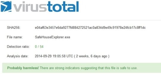

SafeHouse Explorer Portable Version contains no adware, spyware, toolbar installers and is currently safe to use. You should scan the download anyway for your own peace of mind.
Link to report on VirusTotal:SafeHouse Explorer Portable - VirusTotal Report

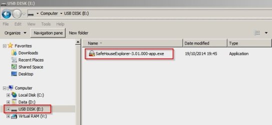

Copy the executable to a formatted flash drive and run directly from the flash drive by double clicking the progam's executable:[/B]SafeHouseExplorer 1.jpg

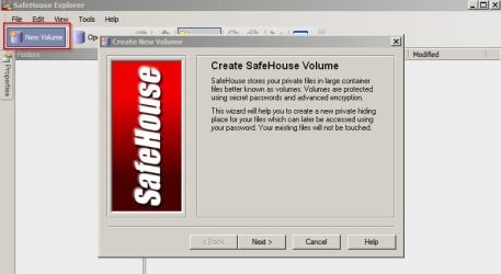

When the GUI opens, select the New Volume tab on the toolbar and the Create SafeHouse Volume Wizard will start.New Volume.jpg

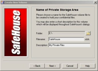

Step 4
Choose a recognizable filename and unique description for your Private Storage Area:
   Tip
It's important to choose a filename that you can recognize - especially if you plan to create multiple volumes

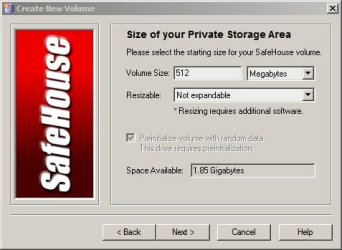

Step 5
Choose the size of required volume in kilobytes, megabytes or gigabytes. The amount of available space is shown in the window.Volume Size.jpg
   Note
Resizable volumes are not available in the free version so choose a size that suits your needs.

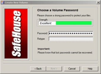

Step 6
Choose a strong password. Password strength is indicated as you type.Choose Password.jpg

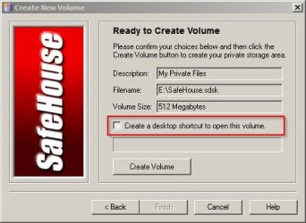

Step 7
You are now ready to create your volume:Create New Volume.jpg
   Note
There is no need to choose the option to create a desktop shortcut to open the volume.
Choose Create Volume and be aware that it will take some time to complete depending on the chosen volume size.
When finished you get the choice to open the volume. If you decide to do so - you can begin adding files or folders straight away via the usual methods.Drag/ Drop

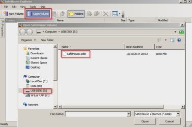

Step 11
Choose Open Volume and click on your required SafeHouse file.Open Volume.jpg
