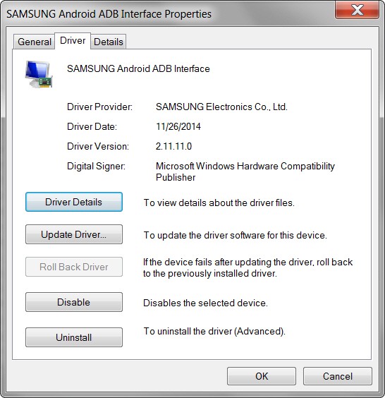

Just double-checked the drivers for my S4 using my laptop. It showed the driver coming from June Fabrics (which is the PDANet+ vendor) dated 2009, rather than from Samsung with the 2014 date as my desktop machine showed. Also, the Hardware ID for the phone was minimalist.
I then did an "update driver software...", specifying to do an automatic search on the web. It came back saying I already had the latest drivers installed.
However a Windows Update icon appeared in the System Tray, and there were several items for Android and MTP and the phone. So I went ahead and installed all of it.
And now, sure enough, the driver on the laptop is now the identical 2.11.7.0 dated 1/2/2014 and coming from Samsung, same as is on my desktop machine. Also, the Hardware ID for the phone had changed substantially, with about 6 more detail lines now appearing. So clearly that's where this driver comes from... Windows Update via Samsung. Perhaps this is related to Android OS updates, or Samsung firmware updates for the phone, or both, but it does seem 2.11.7.0 gets things current and acceptable to Win7.
So I don't know how this squares with the latest 1.5.49.0 driver from that AndroidXDA site. All rather confusing, but it does seem 2.11.7.0 from MS Windows Update is what my Win7 environment believes is appropriate. And I do have complete MTP control over the phone and its internal/card storage contents through Windows Explorer.

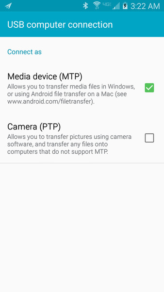

As I stated earlier, MTP is certainly the way to configure the USB connection on the phone.

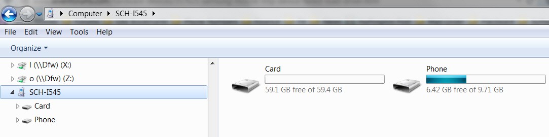

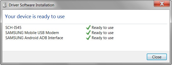

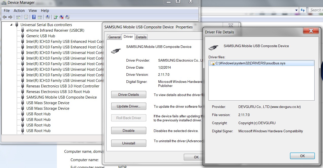

Here's my Verizon S4 connected to one of my PC's:
You can see that the drivers on this particular PC are 2.11.7.0 from Samsung, which are older than yours.

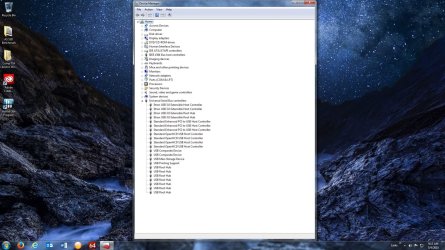

wow before you replied I tried
USB Driver - General Fix for Problems
now I cant even get any read that its there it doesn't show in Device Manager
This wasn't posted correctly. It's not a URL link, so I don't know what web site solution you were looking at.
You need to open the USB category to see the Samsung device. That's where the phone shows up as one of the USB devices, inside of USB... not a primary category of its own in Device Manager.

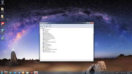

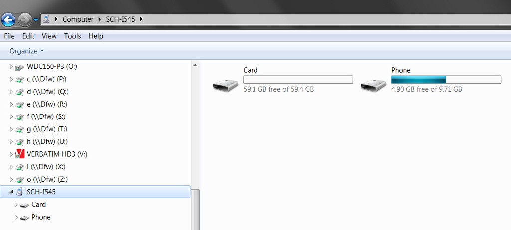

:rolleyes: I already known it was not in usb devices but here is a pic,,, my sprint SGs4 always showed as a portable device

here is my latest and cant find a link to download the 2.11.4.0 driver

Ok. If you still need USB drivers for Samsung Android, try this page and grab the Feb 15 update installer zip, unzip it, and run it. It's installer package 1.5.51.0 dated 12/4/2014. It contains Samsung Windows 7 64-bit drivers for Android, version 2.11.11.0 dated 11/20/2014.
When you plug your phone in, the drivers for the device will get installed.
If you look in Device Manager, you'll see two items:
(1) In the USB group will be Samsung Module USB Composite Device
(2) In the Samsung Android Phone group will be Samsung Android ADB Interface
Right-click on both of those devices and select Properties -> Driver, and it will show 2.11.11.0 dated 11/26/2014.
Explorer will show your Galaxy phone as an MTP device (i.e. with no drive letter assigned, but with it accessible by name, and then internal and external storage.
And the phone itself will show that it is USB-connected as a "media device" (MTP).
