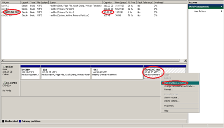

Okay thanks, sorry, I just got irritated there. Thank you for your help. I am positive that it is not marked active because that is one reason why I think it will not boot. The EasyUS Partition Master I use has the availability to mark it active if I wanted:

Hey zachattack; If you delete the recovery partition it will have no affect on the stability of windows. However; if you do delete the recovery partition, you will have no way of resetting the computer to factory condition.
Alternatively, you could download the ISO image and burn it to a disc and use that to reinstall the OS using your OEM product key code form the laptop.
