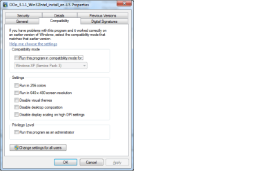

Did you try to select the setup.exe, then right-click, properties, then select Compatibility tab?
Select the preferred Operating System, and it might work for you.
Best regards,
zx81
I have the same problem even in:
- compatibility mode or administrator or both.
- trying to get latest driver form Samsung
And manual installation
Any other Idea or do we just have to wait until Samsung notice there is a problem?
Thanks if any one can help

yes, i tryed it before i started to hack the registry. :)
nothing happened. :(
