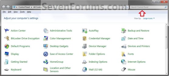

3. Open the Control Panel in Windows 7 or Windows 8, type scanners and cameras in the search box at the top right corner, click/tap on the View scanners and cameras link, and go to step 4 below. (see screenshots below)

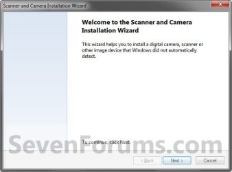

6. Click/tap on Next. (See screenshot below)

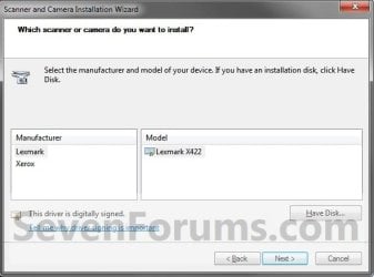

7. The wizard will prompt you to select your scanner or camera from a list. If your scanner or camera isn't listed, you'll need to obtain drivers for it, either from the manufacturer's website or the installation disc that came with the device. Click/tap on the Have Disk button when asked to choose your scanner or camera to install the drivers for it. (See screenshot below)
8. Follow the rest of the onscreen instructions to add the image device.
