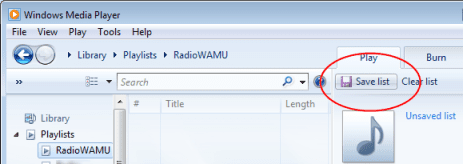

After that you need to SAVE that playlist (check screenshot in attachment).
In your case it disappeared because you did not save it. Save it and close Media Player.
Now, bat file should work.

start /high mms://wamu-wm.streamguys.com/WAMU-1 <--This wont work.
start /high C:\"Program Files"\"Windows Media Player"\"wmplayer.exe" /playlist radioWAMU
