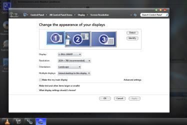

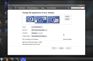

Okay, I am running three monitors on two graphics cards. ( :cool: )
I have a screensaver that spans all three monitors. ( :cool: :cool: )
My problem is, when the pc turns the monitors "off", it resets the monitors.
(confusing)
I want my middle monitor (Monitor 2) to be my primary monitor, and monitors 1 and 3 to be extensions.
Scenario is:
  • I let the screensaver run (busy on laptop or out of the bedroom or whatever...)
  • monitors turn off
  • I wake the pc up
  • monitor 1 is primary display instead of monitor 2.
is there a way to "Lock Down" the settings for the screen resolutions so they can't be changed by anyone or anything without the password?
