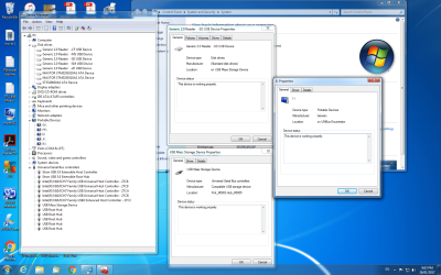

Old thread but relevent question.
I have installed a 3.5” internal card reader and while all appears to be working, or should be, the cards are not able to be browsed or used. (I have actually tried 2, a generic and one from an HP Presario, both of which worked in the previous PCs.)
The USB port on the front of the reader works fine and in fact I can use a really cheap and nasty little plastic external card reader through this port and it works. So too does a USB memory stick. The card slots will not show up in Windows Explorer.
The card reader was initially showing up as a “Mass USBStorage Device” in the USB controllers section of Device Manager. (The cheap external one shows up the same way and it works.) In Portable Devices section of Device Manager the drive letter assignations of G,H,I ,J & K were made. If a USB stick was used in the reader’s USB port it was given drive letter L. These devices were all shown to be working properly and using Microsoft 2006 drivers. The “Details” tab of “Properties” for each drive letter even showed which type of card was recognized. CF, XD, SD & MS etc.
Disk Management showed these drive letters with “No Media”. The LED next to the card lights up when a card is inserted but nothing is accessible. Disable, Enable, Uninstall, reinstall, remove, replace, reboot, etc, all does nothing.
So, I used Driver Booster 4 to scan for driver updates. As it was scanning I noticed “Generic USB 2.0 card reader” flash through a couple of times. I had already done all other drivers before installing the card reader so it should only be looking at the reader. I allowed it to download and install whatever it wanted to and now the “USB Mass Storage Device” has been replaced with “RealtekUSB 2.0 Card Reader”. The “PortableDevices” section is gone completely and Disk Management no longer shows the drive letters as assigned or there at all.
I have blown the slots out with compressed air and sprayed electrical contact cleaner onto the contacts.
Any ideas would be appreciated?

Well, after lots of research and sorting out ridiculous suggestions from actual informed possible solutions, I have found that this issue is quite widespread and by some accounts only presented after certain W7 updates. In other words, working readers stopped working after the updates.
The machines that originally had my readers working were running XP Pro and Vista Home. I'm going to disconnect my 2 HDDs with content and install XP on the blank disk. If the reader works, it is a W7 issue.
One other interesting thing is that some people report this problem to be only affecting the SD Card slot of their multi-card reader. I will have to go and dig out a Sony Memory Stick to see if mine does the same.
I have turned the "Hide empty drives" off in Folder Options / View tab. All this does is show that the disk slots are there but don't detect inserted media. Contrary to some suggestions, this does not fix anything.
Just for interest here is a screen shot from Windows 7 Device Manager showing that the reader is recognised and apparently "working properly". This is what it looks like with the Generic 2006 Windows drivers. It changes when Driver Booster 4 detects the reader as a Realtek 2.0 Reader.

No different in Windows 10
Well I couldn't get XP to install on this computer so I did a Windows 10 Home Single Language install instead.
Windows 10 is performing exactly the same as 7. Generic drivers from Microsoft 2006 show as Mass USB storage device, lists drive letters in Portable devices and shows each slot by type as a drive in Disk Drives. Drive icons can be seen in File Explorer, or not, by changing Hide empty drives setting and Disk Management shows slots as drives with No Media.
Driver analysis software detects the Card Reader as Realtek and once these drivers are updated it behaves as described in thread above. ie Portable Drives gone from Device Manager and missing from Disk Drives. They can be shown by in-hiding them.
Next step is to try a Memory Stick in the appropriate slot to see if the reader is only dropping the SD slot.
Then put the whole Card Reader back in it's old machine and see what it does there.

Sd Card Only
It is, or appears to be, the SD Card slot only that doesn't work. I put my Memory Sticks in and they read just fine.
Or perhaps it is just that the SD Card reader on this device is not up to handling even 8GB. The Memory sticks are quite oldish and relatively low capacity. I also just noticed in looking at my Micro SD Cards, that they are SDHC, so perhaps the reader simply can't handle that format. I hadn't even considered that the reader might just be too old to handle more recent card chips.
I'm surprised by this as it is a USB 2.0 device and so is the el'cheapo external one that does read the Micro SDHC. I've wasted enough time on it now so it's best to give up.
Next step is to junk it and go get a new one that will read current card chip standards.
