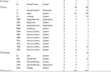

Today the PC had a SLOW start-up, so I ran MalwareBytes & deleted a few files. The scan with MS Security Essentials had no problems. After re-start I was surprised to see a BSOD and then it re-started OK. I ran SeaTools for Windows... in addition to failed tests, SeaTools thinks I have a second HDD in a USB port but there are no flash drives plugged in (just printer, keyboard, & mouse in the back ports)
Why does SeaTools think a USB port is a HDD? (is this a hint of hidden problems?)
PC seems to be running OK now but the failed tests with SeaTools are a concern.
What are my best steps from here?

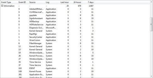

Here's the SeaTools Log + (attached) view of Event Log Summary A & B
