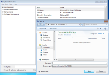

So attache to post remains logs:CBS.log,log from VistaSysInfoTool and firegenReport.htm.Besides
File>>Search>>msinfo32
next File >>Save as any name attache *.nfo file too.It looks like any issue with any service

I have attached the CBS file from C:\Windows\Logs\CBS,the firegenReport.htm and the output from VistaSysInfoTool (all checkboxes ticked as I was unsure as to what you required).
I was not sure what you meant by
sorry!
there was no msinfo file, just the application and I didnt know what is needed from that, and there were no *.nfo files when I searched my C: drive (the only drive attached)
*.nfo include general information about hardware,drivers,environments variables,services
If you already genereted *.nfo file it should be in Documents folder,of course if you didn't change location.

I didnt realise that I had to do a 'save as', how embaressing :(
anyway, it is attached in a zip file (although I can't check it on my pc as it complains that it is invalid or incompatible with the verison of msinfo32 i have :sarc:.
