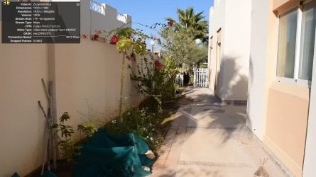

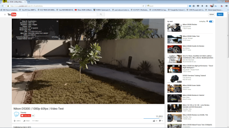

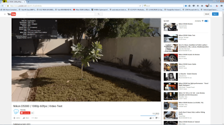

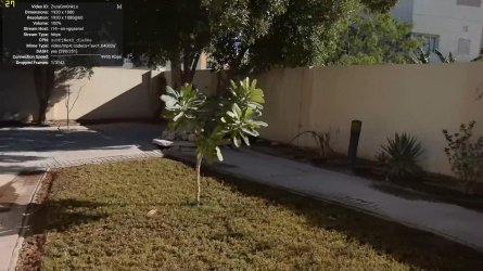

it doesn't matter if i use firefox or chrome, h.264 1080p 60fps videos on youtube simply won't play without problems.
720p 60fps videos play smooth with less than a dozen dropped frames the entire length of the video.
yet, my CPU can decode 720p 60fps vp9 videos without any problems either (unless you count the high cpu usage).

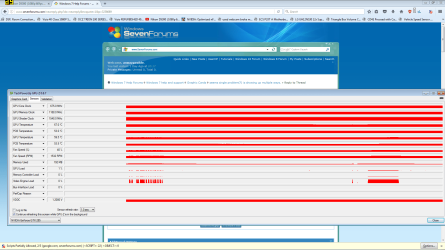

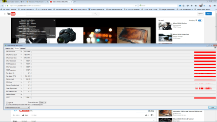

i had gpu-z open while watching the youtube video & it said the video engine load was in the 70% - 80% range throughout the entire video.
(the heat wasn't high either, i forgot to look at the temps after the video was over - but i know the errors start immediately after stats for nerds says the resolution changes to 1080p 60fps .. plus the fan spins up faster if it gets really hot (and it never-ever does) ..i watched a different 1080p 60fps video earlier & that time i looked at the temps and they were low, & i seen the fan speed went from the normal 40% up to 43%.
(plus i've manually turned the fan up before & it is very loud - enough to grab my attention if it did spin up)

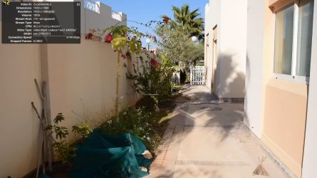

the weird part about the youtube videos is .. sometimes the video will simply pause & then jump ahead as if i tapped the forward seek (because of all the frames dropped) - but other times the video is jerky moving from a start point to a point further into the future & then back to the start point (or even some frames in the past).
put it like this, i watched this roller coaster video & there was a bunch of dropped frames 15025 out of 27112. (the video did some pausing with a buffer icon & it also skipped forward as if i tapped the seek of the progress bar, even though it was simply the dropped frames)
https://youtu.be/oEN5GnaHNLw
the video i watched before that, i don't remember the number of dropped frames but the video was doing the jerky movement again .. and it is easy to know what i'm talking about considering the video.
the roller coaster goes down the track & the scenery gets closer to the camera until it goes off screen.
well the scenery was moving forwards & backwards as if a strobe light.
https://youtu.be/QzVGf-K2heg

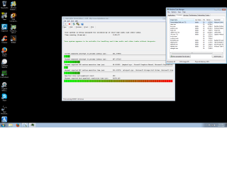

i ran latency mon while playing the game & the spikes from that program weren't consistent with the pauses in the game.
plus the results from the latency mon software didn't show anything abnormally high at the top, everything seemed rather smooth going down in time (nothing stuck out as a problem, other than some high latency on the first page)
and of course i tried to run the program again to post the specifics of what was the highest latency, but the window seems to be stuck in the other screen that was recently unplugged.

i restarted the computer & didn't open my audio processing or my magicjack.
i ran latencymon long enough that it would pick up something right away if there was a problem.
here are the results from that:
there didn't seem to be a problem reported by latencymon, thus i went into the game hoping the problem was sorted - but the pausing for a split second is still there.

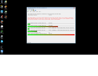

i came out of the game & looked at latencymon and it had this to say:
technically ISR & DPC aren't showing red & that makes me think those two are okay.
but the interrupt to process delay is very high.
this is what the software says an interrupt to process delay is:
'The interrupt to process latency reflects the measured interval that a usermode process needed to respond to a hardware request from the moment the interrupt service routine started execution. This includes the scheduling and execution of a DPC routine, the signaling of an event and the waking up of a usermode thread from an idle wait state in response to that event.'
with that said, i know the DPC routine is low enough to avoid being red flagged by the graphic meter.
that leaves the scheduling, the signaling of an event, & the waking up of a usermode thread from an idle wait state.

another thing i noted while looking at the latencymon software was how it listed the ISR & DPC count in execution time categories.
all of my ISR execution times were <250 µs.
all but 10 of my DPC execution times were <250 µs.
those 10 fell into the 500-999 µs category.
the software said the driver with the highest DPC execution time was 'nvlddmkm.sys - NVIDIA Windows Kernel Mode Driver, Version 341.81'
yet i found this to be intriguing:
Highest reported total DPC routine time (%): 0.141141
percentage tells me, despite the amount of microseconds it took - the most active falls into this category:
Driver with highest DPC total execution time: USBPORT.SYS - USB 1.1 & 2.0 Port Driver, Microsoft Corporation
i also thought this was brilliant:
CPU 0 Interrupt cycle time (s): 50.482396
CPU 0 ISR highest execution time (µs): 144.720
CPU 0 ISR total execution time (s): 10.308065
CPU 0 ISR count: 1757644
CPU 0 DPC highest execution time (µs): 728.520
CPU 0 DPC total execution time (s): 29.451936
CPU 0 DPC count: 6878218
CPU 1 Interrupt cycle time (s): 9.033921
CPU 1 ISR highest execution time (µs): 0.0
CPU 1 ISR total execution time (s): 0.0
CPU 1 ISR count: 0
CPU 1 DPC highest execution time (µs): 60.92250
CPU 1 DPC total execution time (s): 0.185206
CPU 1 DPC count: 66694
CPU 2 Interrupt cycle time (s): 9.036362
CPU 2 ISR highest execution time (µs): 121.436250
CPU 2 ISR total execution time (s): 0.384187
CPU 2 ISR count: 33130
CPU 2 DPC highest execution time (µs): 180.75750
CPU 2 DPC total execution time (s): 0.750410
CPU 2 DPC count: 95434
CPU 3 Interrupt cycle time (s): 7.609548
CPU 3 ISR highest execution time (µs): 0.0
CPU 3 ISR total execution time (s): 0.0
CPU 3 ISR count: 0
CPU 3 DPC highest execution time (µs): 176.463750
CPU 3 DPC total execution time (s): 1.126990
CPU 3 DPC count: 32297
there isn't an ISR count on two of the cores.
the amount of seconds doesn't add up to the number of seconds i was playing the game (though would all of those whole seconds add up to the total number of split second pauses? ..well if a round in the game is 10 minutes and the split seconds are simply half a second, then no there aren't enough seconds listed for that to be possible.
yet, what if the 'event' was much much less than half a second while the consequences of said 'event' are much longer? then perhaps those numbers would add up.
it doesn't make sense why there are DPC's on all four cores, yet the ISR's are only on two of those cores.
it also doesn't make sense why three of the cores interrupt cycle time is about the same, while the other core is almost ten times as high.
the highest DPC execution time on all the cores comes from core 0 and is: 728.520µs
the driver with the same amount of time is: nvlddmkm.sys - NVIDIA Windows Kernel Mode Driver, Version 341.81
that made me think the nvlddmkm.sys driver isn't scaling at all & it makes me wonder if it did, would the problem be less or gone entirely?
here's something else interesting, the ISR total execution time + the DPC total execution time = 39.760001 seconds.
yet the software says the interrupt cycle time is 50.482396 seconds.
there's 10.722395 seconds missing & that number isn't anywhere on the other cores either.
what is that, my digital I.D. number for the dark web?!
from 4 to heel, from heel to heal - somebody wants my job dire bad & is willing to torture & abuse me to tell me about it?!
the difference between these two tells me something is seriously wrong:
Highest measured interrupt to process latency (µs): 5593.413851
Average measured interrupt to process latency (µs): 4.843626
if the industry isn't going to give me a tool to look into the interrupt to process mechanism, as far as each instance of progress & the timing of those instances - then it isn't up to me to fix & thus microsoft should be fixing it rather than me suffering with it.
makes me wonder if microsoft is fighting with another software and|or driver developer causing the two to be less than a harmonious set.
the hardware is sold for microsoft, it is advertised.
how are we supposed to play with legos if the buttons & holes don't line up?!
the industry is supposed to be a solid lock, rather than an unstable situation where the most simplistic forms of life could knock those pieces apart (such as the vibration of the floor when walking away, or too much wind, or any single person that lacks enough care to touch those pieces .. plus how are we supposed to build without wanting to cheat by leaning those pieces up against a wall? walls aren't freedom, they are confinements that hinder freedom.)
it says the direct x graphics kernel ran for 13947.361568 milliseconds.
i don't like the math of those numbers for personal reasons (considering it could ever be conceivable the numbers after the decimal point bite at the numbers before the decimal point with higher priority and|or occurance).
can anybody bring some light upon the scheduling, the signaling of an event, & the waking up of a usermode thread from an idle wait state?

well that made me curious about the video engine load.
i fired up gpu-z & hit the replay button in full screen.
at the beginning it ran, but a few seconds later i seen the dropped frame counter go up & my audio started to crackle (has been a frequent problem that happens dozens of times a day or dozens of weeks go by without it happening once).
i got out of the video & reset the audio driver & went back to the video & let it play until it was finished.
the video would play for some seconds, 20? & then the dropped frame counter went up with a hundred or more dropped frames - but the audio wasn't crackling again.
the video went back & forth between smooth & lots of dropped frames - the audio didn't crackle for the rest of the video.
i got out of the video & looked at gpu-z & it showed the video engine load with moments of 0% use.
yet my internet is 10mbit/s & it's 1am & besides - the video was technically already fully loaded because it played to completion before a moment ago.
here's a screenshot of gpu-z (max video engine load was 91%)

i turned vertical sync on & restarted the browser, went to my favorite reference video for quality & well look for yourself:
the video was tearing & the frames per second aren't a multiple of 60 either.
the video engine load was steady that time, going back & forth between 90% & 91%:
doesn't make sense to me.

global vertical sync didn't help either.
both times i've had it on (either with the browser specifically or globally) the video looked worse.
it was blurry in some parts & there was compression artifacts in other parts.
the video engine load did basically the same thing.

forgot to mention, when i watched the video above (the one with global vsync turned on) the video ended early before all of the content was played on my screen.
here is a picture of the artifacts:
there's a reduction everywhere in that screenshot really, but especially noticeable on the wall.
