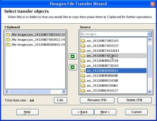

Alright, will continue with the file retrieving process tomorrow (it's in the middle of the night over here). Can you elaborate on how to use the Rescue Kit?
After that I will try to repair the HD. Thanks for the advice :)
Boot into Rescue CD, choose File Transfer Wizard, then copy out your files to DVD, external, or another HD.

Alright, I just did that. So now I will put it in to my laptop.
I chose normal mode and then File Transfer.
Under the source column the following appeared:
/(Root dir)
/MyComputer (my computer)
/mnt (Mounted resources)
/mnt/disk (Local disks)
/media (Removable disks)
SCSI CD/DVD (HL-DT-S DVDRAM GT 31N)
C:\ (NTFS, 0 on Disk 0) (PQSERVICE)
D:\ (NTFS, 1 on Disk 0) (UFSD disk - SYSTEM)
E:\ (NTFS. 2 on Disk 0) (UFSD disk - Acer)
What do I choose now?
EDIT:
This is silly. I chose the last one, but I can't select the "Users" folder, because every time I scroll down, the bar goes up again, making it completely impossible to choose the folder where all my files are.
What can I do to solve this problem?
Try using the down arrow then Enter instead of mouse which may lack functionality on booted CD.
If this fails, try the other method using the WIn7 REpair CD:
http://www.sevenforums.com/tutorials/2083-system-repair-disc-create.html
http://www.sevenforums.com/tutorials/93347-copy-paste-windows-recovery-console.html
I managed to get it to work after a while, so all my files have safely been copied to my external hard drive, which I'm of course extremely delighted with :)
