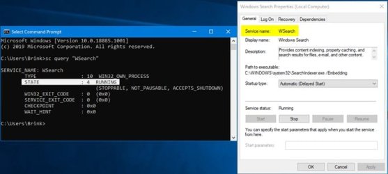

2. To Stop a Service using "Sc Stop" Command in Command Prompt
A) In the elevated command prompt, type the command below, press Enter, and go to step 5 below.
NOTE: The Service name of a service is displayed in the service's properties.
sc stop "service name"
For example:
If I wanted to stop the HomeGroup Listener service, I would type the command below using the HomeGroupListener (service name) exactly in the command prompt, and press Enter.
sc stop "HomeGroupListener"

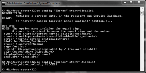

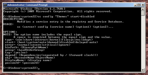

3. To Disable a Service using "Sc Config" Command in Command Prompt
A) Do step 2 above to stop the service.
B) In the elevated command prompt, type the command below, press Enter, and go to step 5 below.
sc config "service name" start=disabled
For example:
If I wanted to disable the HomeGroup Listener service, I would type the command below using the HomeGroupListener (service name) exactly in the command prompt, and press Enter.
sc config "HomeGroupListener" start=disabled
