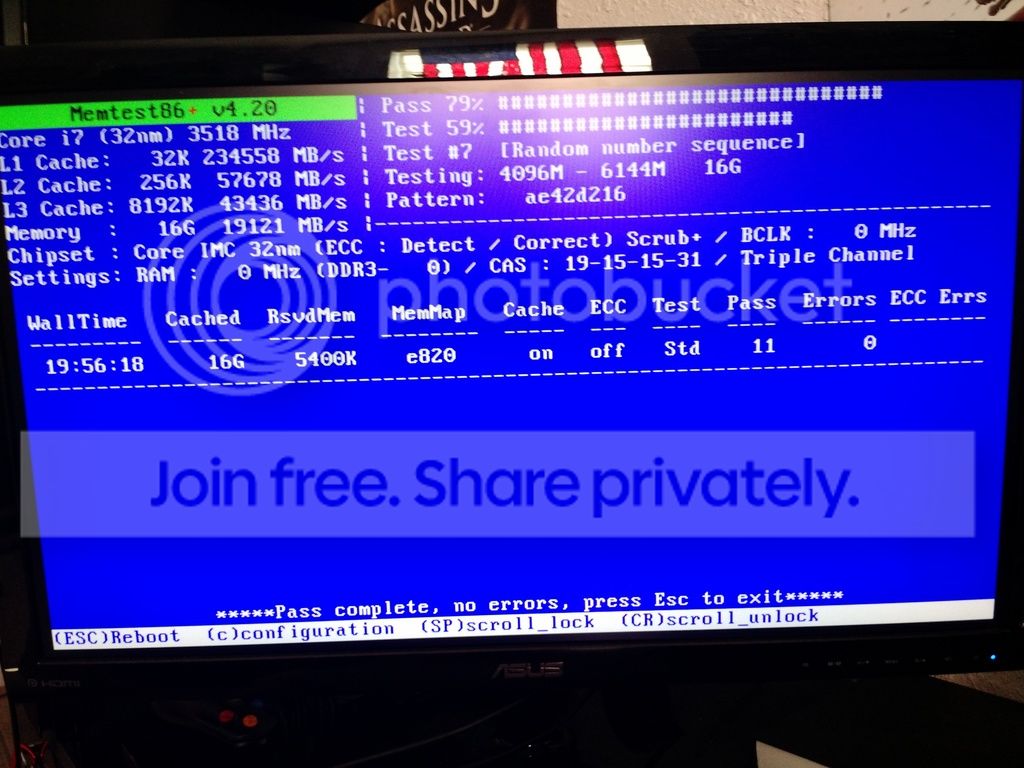

Alright, I ran it all day while at work, came home and checked it, then went to bed, woke up and it had 11 passes with zero errors. Here's the photo you requested as well Arc.

Nice!
Then let us check other possibilities .... if there is a failing driver that is passing bad information to the memory, that may result in memory corruption, too. So let us enable Driver Verifier to monitor the drivers. Run Driver Verifier for 24 hours or the occurrence of the next crash, whichever is earlier.
