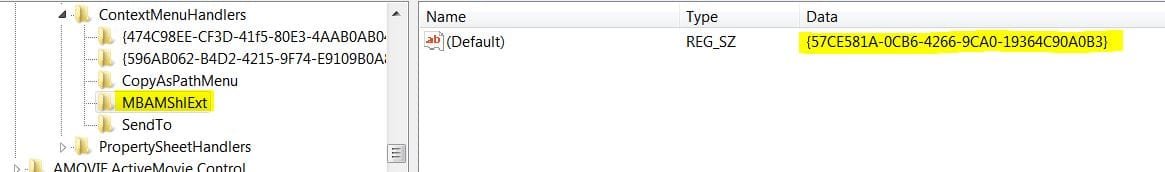

Could someone with MWB tell me if they have this key?
HKEY_LOCAL_MACHINE\SOFTWARE\Classes\AllFilesystemObjects\shellex\ContextMenuHandlers\MBAMShlExt
Default {57CE581A-0CB6-4266-9CA0-19364C90A0B3}

Not sure what you mean by "properties via right click from programs". I have the same value for MBAM. That's the shell extension that provides the right click menu for MBAM.
