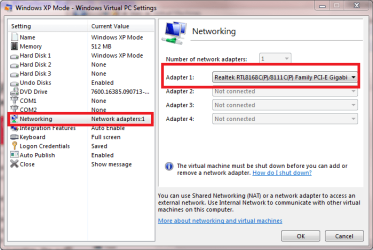

OK. To start, 3GB vhd for XP is awfully small! But, that's what you now have. To be able to see the host's drives, you need to change the used network adapter from the XP virtual machines settings. I have not a Virtual PC 2007, but this screenshot from my newer Virtual PC shows what I mean:
After that you should see the host's drives.

Hi Kari,
Attached an image which shows the network drives selected in my virtual machine settings. On the left hand side of the image you will find the Windows 7 device manager which shows the network driver installed and on the right hand side shows the virtual pc settings network settings where the same is selected. But still i dont see the host drive in the virtual pc xp os.
Please suggest me what needs to be done...
