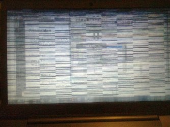

Hello all,
This Samsung Series 5 Ultrabook has been returned to us for the 4th time because the customer consistently complains that the notebook apparently shows graphic issues, even though we have tested it with every testing tool we have and these issues could not be reproduced. The specs are:
NP530U4C-S02DE
Intel Core i5 2537M @ 1.40 GHz
4 GB RAM
Windows 7 Home Premium 64-Bit
The Notebook was sent back to us and was tested for almost 2 weeks and the problem could not be reproduced. The steps taken so far:
Graphic test with FurMark - 3 times for 8-10 hours
CPU test with OCCT - 3 times for 8-10 hours
RAM test with Memtest - 1 time for 7 passes
BIOS updated to the newest version
Intel burn-in test - 3 times
Daily normal use tests - 7 days
Graphic drivers - last 2 versions used and the customer says the problem still happened.
The Notebook runs completely stable when it is with us, but as soon as it returned to the customer for the second time, this problem appears its nasty little face. I have included a picture from the customer showing the graphic problems she has experienced. This problem we have not had at any time it has been with us for testing.
Maybe someone here can point me in the right direction, because we have all but expended our testing options.
*Pictures attached*
Windows 8 Professional 64-Bit
I can think of two possibilities:
Could this be an unstable power (wall socket) issue? Has the owner tried to run this laptop just from the battery, and maybe a different wall socket/outlet, to see if the issue still occurs?
How is the laptop used? Is it possible it is being used on a blanket/lap where the air vents are being blocked, causing the GFX card to overheat?

Unstable wall socket is not possible because there are 4 other notebooks being run from this power strip and are working fine. GPU temps are normal, I checked these with GPU-Z and our GPU diagnostics tool. This problem appears to be a Samsung issue. I have now 3 notebooks with the same issue. The first two are Samsung Series 5 Ultrabooks and the other is a Samsung NP300E5C. These notebooks ALL have Nvidia GT 620 M and Intel HD 3000 graphics. I think there may be a pattern here.

It does seem that way, but unfortunately our customers are professional business people and never want to hear that. I have sent our Samsung representative an E-mail regarding these graphic issues. If no service bulletins regarding this are put out by Samsung, the customer must live with it because it will be on their end.

My girlfriend has a Samsung Series 5 ultra book presenting the exact same graphic glitch, we come to realize that has to do with the manipulation of the equipment. 95% of the time the glitch appears when she grabs the laptop from the sides (it happened a few times to me too while using her laptop). It is not a hard grab, even when she lifted it grabbing it from both sides the glitch appears.
She have the equipment for a year or so and keep happening once a week or so.
I don't know the internal configuration of the equipment but It seems that the graphic card is on either side of the keyboard and the pressure (or movement) triggers the glitch.
