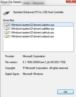

Here is the drivers on my system. What does yours show and are these files still on your system and what version.

Here it is:
(Note:
  • usbhub.sys & usbport.sys have the same details as yours
  • usbehci.sys is different
  • usbfilter.sys is there from AMD)
