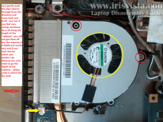

Yep that is the way it is too gln and if your Dad blew from the fan side it would have packed the dust and crud harder against that small "radiator" you see in the pics that the heat pipes run through.
So what I do and if you are VERY gentle you can get some pipe cleaners or those craft work wires that have the spiky look about them I don't know at they are called and very slowly push them through the slots from the OUTSIDE so it loosens the dust and crud and it will tend to blow it out a bit with the fan running or while you are blowing with the compressed air can from the fan side if the fan isn't running. But only do it as long as you can feel fairly free movement od the claener in the radiator.
This isn't so good as taking the thing apart and I admit it is quite an undertaking if you have never done it before. For those cleaners see Pipecleaners | Officeworks or just Google pipe cleaners you will get pics of what I mean. Kids Crafts - Pipe Cleaner Crafts - 5 Easy Pipe Cleaner Crafts

Sorry late reply mate as Bear says spinning that fan is not a good idea as the compressed air does spins it way faster than it was designed to.
The only way to properly clean it is to take it down but if you are not sure don't try as it does take a fair bit of dismantling.
The screws are very small and some are tucked away where you don't naturally see them. The other important thing is with those ribbon cables if you look at that site again the home page shows you how small those little retaining lugs are that need pulling outwards to release the grip on the cable. Not so bad taking it out but very important when replacing them and you will have to remove some because they run over the bottom panel in some spots making lifting the plate impossible.
Having said that once off it is quite an easy job to clean the "radiator" once the fan is removed with a hogs hair brush (not a synthetic bristled brush) and the compressed air - the fan simply unscrews / unplugs and lifts clear of the motherboard before you do that.
