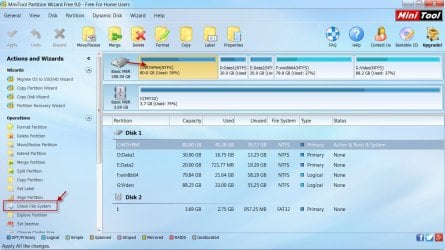

Create a bootable CD/pendrive with Partition Wizard Bootable CD Free version - 75 MB Free download Magic Partition Manager Software, partition magic alternative, free partition magic, partition magic Windows 7 and server partition software - Partition Wizard Online boot from it with your 1TB drive connected and run Check File System on it.
(Since your system is UEFI you may have to disable Secureboot and set to Legacy Mode to boot from the CD or pendrive)
Screenshot: (For illustration only. You will run the Filesystem check on your 1TB drive parttiion/volume)

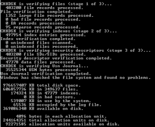

Thanks for the hot swap idea, never knew i could do such a thing, it worked wonders. Still stuck at the bios splash screen if the HDD is connected to my mobo before post. So i disconnected that HDD's SATA cable from the mobo and did a re-boot. On my spare 500GB drive, I installed windows and did chkdsk on the problem hard drive(did the hot-swap thing; connected the drive's SATA cable to my mobo once i was in the OS).
Above is the result. I couldn't make sense of anything other than the obvious, the statement that says the drive is fine.
I still experience my initial problem; i have yet to run chkdsk [drive lettering]/R. I'll give you an update when i'm done.:)
