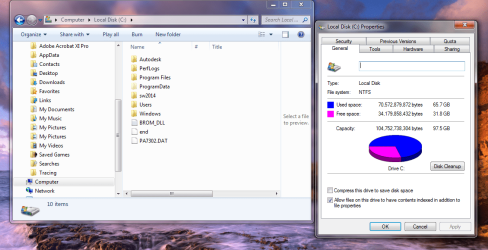

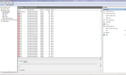

thank for replaying dear Anka there is a lot of files (information,error, warning) is it okay and my computer says that i have 31.8 gb free of 97.5 but in disk c it says 57.1 GB is used what to do please help and i have updated all Windows Updates (154 files)

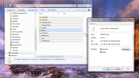

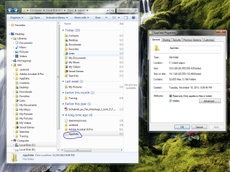

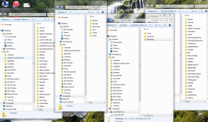

what files the marked folder contains are there important files or i can just delete them here are the files below in screenshot pictures

You need to click on one of the errors to show why it erred then take a screenshot of those details and upload.
Don't worry about the disk amounts for now.
   Warning
Do not delete any files!
Did you see any C++ or .NET in Programs and Features?

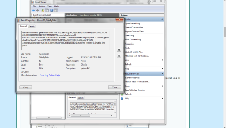

Here's a reason for those Event ID 59 Errors: Source: SideBySide Event ID: 59 (Windows Operating System 5.2) - Technet Events And Errors Message Center: Message Details But, we need you to open one of them to specify what the error says under details.

When you select all under C:\ and query properties, it is possible that hidden/protected system files were not selected. Possibly pagefile.sys.
Also, click the button and paste here. (seems I got a side-by-side myself from ESET Online :))

hear it is

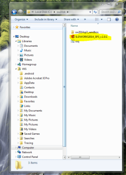

I have brought this program on a usb flash is there any problem ??

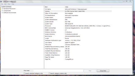

The requirement for Solidworks2014 SP3 is you need SP1 for your Windows 7 Ultimate operating system; You do not show SP1 as installed in your system specs.
Do you have Windows 7 Service Pack 1 installed or not?

How to check wheather have or not ??
custom build
windows 7 ultimate 32bit

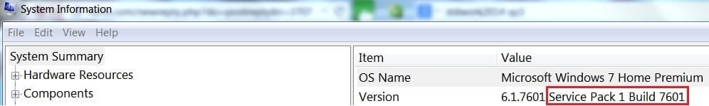

Use this: System Information check the second listing down named "Version" it will tell you there, if you don't see it like in mine, you don't have it and need to install it.

no i have got it

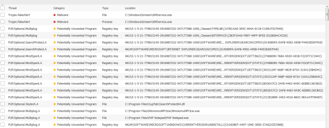

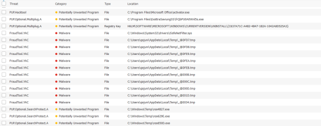

I have done the scan and there are yelow and red marks must the red ones be delleted

i have done the scan must the red ones be deleted?? what to do whit the yellow ones
