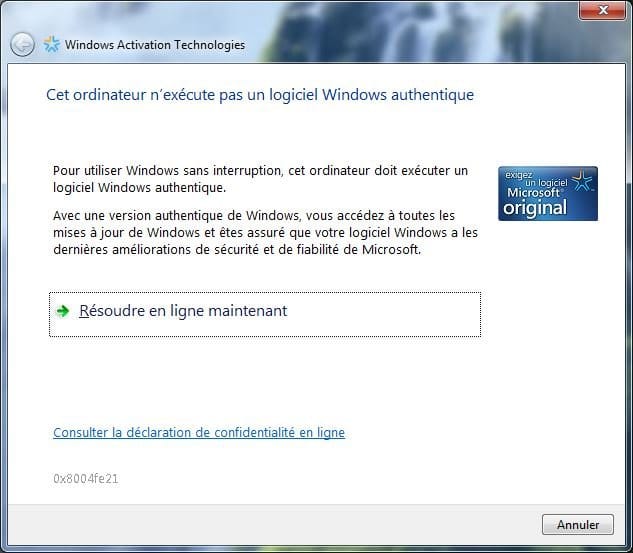

Hello
I am restarting an old alienware M15X having the original Dell Windows 7 Pro updated with SP1.
I have replaced the original hard disk (500Go) with a new SSD (1T).
After making a disk clone using clonezilla with success, the original disk just crashed having bad sectors.
The labtop reboots sucessfully with the new SDD. All is OK.
The System Configuration Panel indicates that Windows is activated. There is no activation requested.
But sometimes the popup panel "windows is not genuine" appears with the error 0x8004FE21
slmgr /rilc command is ok but has no effect.
Note that the KB971033 is installed.

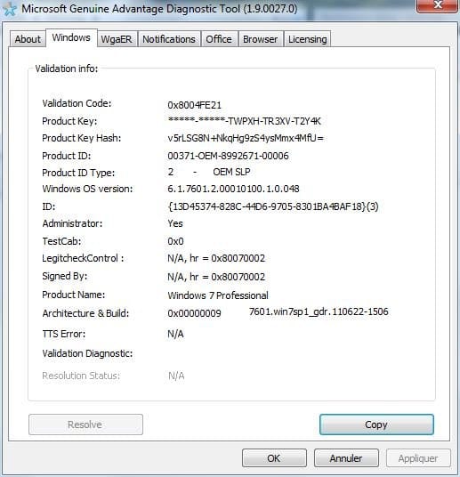

The MGA Diag report :
Diagnostic Report (1.9.0027.0):-----------------------------------------Windows Validation Data-->Validation Code: 0x8004FE21Cached Online Validation Code: 0x0Windows Product Key: *****-*****-TWPXH-TR3XV-T2Y4KWindows Product Key Hash: v5rLSG8N+NkqHg9zS4ysMmx4MfU=Windows Product ID: 00371-OEM-8992671-00006Windows Product ID Type: 2Windows License Type: OEM SLPWindows OS version: 6.1.7601.2.00010100.1.0.048ID: {32F1C6F3-9A2A-4470-AB91-5E591C903319}(1)Is Admin: YesTestCab: 0x0LegitcheckControl ActiveX: N/A, hr = 0x80070002Signed By: N/A, hr = 0x80070002Product Name: Windows 7 ProfessionalArchitecture: 0x00000009Build lab: 7601.win7sp1_ldr_escrow.190220-1800TTS Error: Validation Diagnostic: Resolution Status: N/AVista WgaER Data-->ThreatID(s): N/A, hr = 0x80070002Version: N/A, hr = 0x80070002Windows XP Notifications Data-->Cached Result: N/A, hr = 0x80070002File Exists: NoVersion: N/A, hr = 0x80070002WgaTray.exe Signed By: N/A, hr = 0x80070002WgaLogon.dll Signed By: N/A, hr = 0x80070002OGA Notifications Data-->Cached Result: N/A, hr = 0x80070002Version: N/A, hr = 0x80070002OGAExec.exe Signed By: N/A, hr = 0x80070002OGAAddin.dll Signed By: N/A, hr = 0x80070002OGA Data-->Office Status: 109 N/AOGA Version: N/A, 0x80070002Signed By: N/A, hr = 0x80070002Office Diagnostics: 77F760FE-153-80070002_7E90FEE8-175-80070002_025D1FF3-364-80041010_025D1FF3-229-80041010_025D1FF3-230-1_025D1FF3-517-80040154_025D1FF3-237-80040154_025D1FF3-238-2_025D1FF3-244-80070002_025D1FF3-258-3Browser Data-->Proxy settings: N/AUser Agent: Mozilla/4.0 (compatible; MSIE 8.0; Win32)Default Browser: C:\Program Files (x86)\Mozilla Firefox\firefox.exeDownload signed ActiveX controls: PromptDownload unsigned ActiveX controls: DisabledRun ActiveX controls and plug-ins: AllowedInitialize and script ActiveX controls not marked as safe: DisabledAllow scripting of Internet Explorer Webbrowser control: DisabledActive scripting: AllowedScript ActiveX controls marked as safe for scripting: AllowedFile Scan Data-->File Mismatch: C:\Windows\system32\wat\watadminsvc.exe[7.1.7600.16395], Hr = 0x80092003File Mismatch: C:\Windows\system32\wat\watux.exe[7.1.7600.16395], Hr = 0x80092003File Mismatch: C:\Windows\system32\sppobjs.dll[6.1.7601.17514], Hr = 0x80092003File Mismatch: C:\Windows\system32\sppc.dll[6.1.7601.17514], Hr = 0x800b0100File Mismatch: C:\Windows\system32\sppcext.dll[6.1.7600.16385], Hr = 0x800b0100File Mismatch: C:\Windows\system32\sppwinob.dll[6.1.7601.17514], Hr = 0x80092003File Mismatch: C:\Windows\system32\slc.dll[6.1.7600.16385], Hr = 0x800b0100File Mismatch: C:\Windows\system32\slcext.dll[6.1.7600.16385], Hr = 0x800b0100File Mismatch: C:\Windows\system32\sppuinotify.dll[6.1.7600.16385], Hr = 0x80092003File Mismatch: C:\Windows\system32\slui.exe[6.1.7601.17514], Hr = 0x80092003File Mismatch: C:\Windows\system32\sppcomapi.dll[6.1.7601.17514], Hr = 0x800b0100File Mismatch: C:\Windows\system32\sppcommdlg.dll[6.1.7600.16385], Hr = 0x800b0100File Mismatch: C:\Windows\system32\sppsvc.exe[6.1.7601.17514], Hr = 0x80092003File Mismatch: C:\Windows\system32\drivers\spsys.sys[6.1.7127.0], Hr = 0x80092003File Mismatch: C:\Windows\system32\drivers\spldr.sys[6.1.7127.0], Hr = 0x80092003File Mismatch: C:\Windows\system32\systemcpl.dll[6.1.7601.17514], Hr = 0x800b0100File Mismatch: C:\Windows\system32\user32.dll[6.1.7601.17514], Hr = 0x800b0100Other data-->Office Details: <GenuineResults><MachineData><UGUID>{32F1C6F3-9A2A-4470-AB91-5E591C903319}</UGUID><Version>1.9.0027.0</Version><OS>6.1.7601.2.00010100.1.0.048</OS><Architecture>x64</Architecture><PKey>*****-*****-*****-*****-T2Y4K</PKey><PID>00371-OEM-8992671-00006</PID><PIDType>2</PIDType><SID>S-1-5-21-370252592-731678359-2530875740</SID><SYSTEM><Manufacturer>Alienware</Manufacturer><Model>M15x</Model></SYSTEM><BIOS><Manufacturer>Alienware</Manufacturer><Version>A03</Version><SMBIOSVersion major="2" minor="6"/><Date>20091216000000.000000+000</Date></BIOS><HWID>C21B3D07018400FE</HWID><UserLCID>040C</UserLCID><SystemLCID>040C</SystemLCID><TimeZone>Paris, Madrid(GMT+01:00)</TimeZone><iJoin>0</iJoin><SBID><stat>3</stat><msppid></msppid><name></name><model></model></SBID><OEM><OEMID>ALWARE</OEMID><OEMTableID>ALIENWRE</OEMTableID></OEM><GANotification/></MachineData><Software><Office><Result>109</Result><Products/><Applications/></Office></Software></GenuineResults>  Spsys.log Content: 0x80070002Licensing Data-->Version du service de licences logicielles : 6.1.7601.17514Nom : Windows(R) 7, Professional editionDescription : Windows Operating System - Windows(R) 7, OEM_SLP channelID d’activation : 50e329f7-a5fa-46b2-85fd-f224e5da7764ID d’application : 55c92734-d682-4d71-983e-d6ec3f16059fPID étendu : 00371-00178-926-700006-02-1036-7600.0000-0122010Identificateur d’installation : 006834571156502562278051862526679001532101608285972132URL du certificat du processeur : http://go.microsoft.com/fwlink/?LinkID=88338URL du certificat de l’ordinateur : http://go.microsoft.com/fwlink/?LinkID=88339URL de licence d’utilisation : http://go.microsoft.com/fwlink/?LinkID=88341URL du certificat de clé de produit : http://go.microsoft.com/fwlink/?LinkID=88340Clé de produit partielle : T2Y4KÉtat de la licence : avec licenceNombre de réinitialisations de Windows restant : 4Heure approuvée : 05/06/2026 09:40:53Windows Activation Technologies-->HrOffline: 0x8004FE21HrOnline: N/AHealthStatus: 0x000000000001EFF0Event Time Stamp: 6:4:2026 17:08ActiveX: Registered, Version: 7.1.7600.16395Admin Service: Registered, Version: 7.1.7600.16395HealthStatus Bitmask Output:Tampered File: %systemroot%\system32\sppobjs.dllTampered File: %systemroot%\system32\sppc.dll|sppc.dll.muiTampered File: %systemroot%\system32\sppcext.dll|sppcext.dll.muiTampered File: %systemroot%\system32\sppwinob.dllTampered File: %systemroot%\system32\slc.dll|slc.dll.muiTampered File: %systemroot%\system32\slcext.dll|slcext.dll.muiTampered File: %systemroot%\system32\sppuinotify.dll|sppuinotify.dll.muiTampered File: %systemroot%\system32\slui.exe|slui.exe.mui|COM RegistrationTampered File: %systemroot%\system32\sppcomapi.dll|sppcomapi.dll.muiTampered File: %systemroot%\system32\sppcommdlg.dll|sppcommdlg.dll.muiTampered File: %systemroot%\system32\sppsvc.exe|sppsvc.exe.muiTampered File: %systemroot%\system32\drivers\spsys.sysHWID Data-->HWID Hash Current: OAAAAAEABAABAAEAAAACAAAABAABAAEAln2iBMYnojqykjxqTs0kRm7ZnmP4160f2G2SgiYrdlY=OEM Activation 1.0 Data-->N/AOEM Activation 2.0 Data-->BIOS valid for OA 2.0: yesWindows marker version: 0x20001OEMID and OEMTableID Consistent: yesBIOS Information:   ACPI Table Name	OEMID Value	OEMTableID Value  APIC			PTLTD 			 APIC    FACP			INTEL 		CRESTLNE  HPET			INTEL 		CRESTLNE  BOOT			PTLTD 		$SBFTBL$  MCFG			INTEL 		CRESTLNE  OSFR			DELL  		DELL      SLIC			ALWARE		ALIENWRE  SSDT			PmRef		CpuPm  SSDT			PmRef		CpuPm  SSDT			PmRef		CpuPm

Hi
The report is showing me 2 different things
ID Type 2 (tells me its looking for the Dell default product key)
BUT
the product key is not the W7 Pro Dell default
As this is an intermittant fault the fix i am proposing must be used when in the Non-genuine state
The product key in use is likely the OEM sticker key, Type 8, and that your licencing store has become corrupted

No the server has not been closed thats why your getting the non-genuine
As i said previously the key reported is NOT correct for that Product Type ID
(is it the key from the OEM sticker?? - in the battery compartment)
The instructions rebuild the files in the licencing folder (Software Protection Platform)
Its also showing as Tampered and an invalid slic table
It does not require the product key to be re-input
The SLUI.exe command will require you to be on-line
at a guess i would say that this has been caused by the bad sector issue you had
depending on Clonezilla settings - Bad sectors can be carried over or not
i suggest you also run
sfc /scannow
