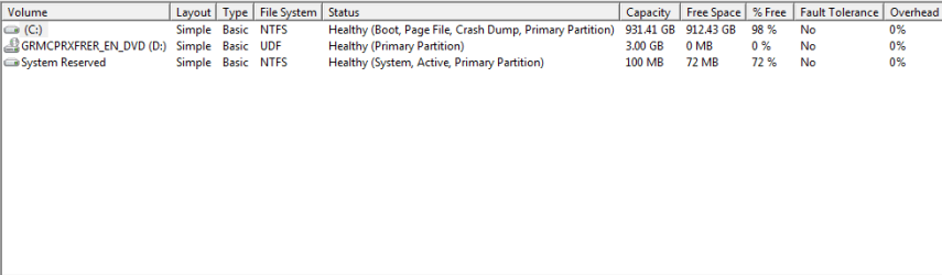

I just got done following the tutorial to a T, save for the parts I didn't care about (like backing up the files and restoring them). But everything else was done identically and I am still receiving that error.
