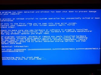

Well I seem to have resolved my own problem. I'm not sure which did it, but I swapped my RAM into the other two bays and did a firmware update on my SSD.
3 hours and no crashes.
mystikal, if you're still having this problem and checking this thread, it might be worthwhile to attempt the same since we seem to be suffering the same symptoms.
