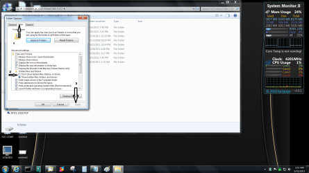

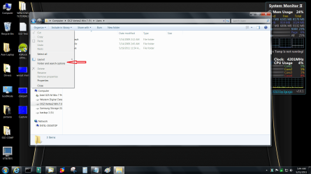

Try this. Go back and open up system reserved in windows explorer. In the top left of the box click on organize and a dropdown will appear.
Next click on folder and search options
Next click on the view tab. click on show hidden in the middle and click on apply
Please Post a screenshot of the contents of system reserved for gregrocker.

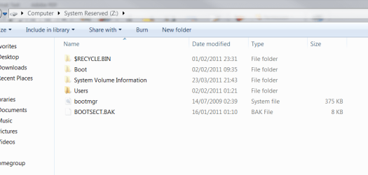

Dear essenbe and Gregrocker,
I have ticked to show hidden files and when this only showed 'User' (which occupies only 6kb on the disc) I also ncecked 'hide operating system files (recommended) to reveal the rest of the files there. Thus the two screen captures.
I would be interested to knwo what this tells the informed.

I have never seen a User folder in System Reserved before. Do you know how it got there? It would have to have had a letter assigned at the time to copy it in there, or for some backup to copy it in.
Once you unhide the files as you did, what is inside the User folder now? Please post back the contents of each folder and subfolder, and the total size.
Do you have your complete User folder on C and are these the files you are working from now? Open some of your active files and look at their Properties to see what the location of the User folder is - it needs to be C.
It's possible the User folder on System Reserved is the cause of the imaging error and it's removal will solve it once we see it's inactive, and if it brings the size of the partition below 34 mb used space. If not, we need to look in the other folders to see if something got written there erroneously as well.
At any point you can also use free Partition Wizard bootable CD to Resize C from the left by 100mb and add that space to System Reserved from the right - an easier fix although I wouldn't want to have a set of User folders in my System Reserved either way.
A Users folder doesn't belong in the system reserved partition and I have no idea what it is doing there. The system reserved is the OS domain and no other application should use it. Space is tight in this little system reserved partition and 50MB is required by the OS for shadow copies during the imaging process.
I would suggest you install the Partition Wizard mini Tool (link given earlier). The explore partition function of the tool will give greater insight than simply assigning sys res a letter and using explorer.
Have a look inside this Users folder and post back the result.
