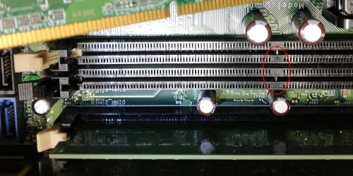

I, too, am a fan of Crucial memory. However, in this case the Crucial website indicates the GA-P55A-UD3 takes low-voltage memory (1.35V), whereas the GA-P55A-UD3 spec sheet seems to specify 1.5V memory. The spec sheet seems to be consistent with the memory in your photo, so I'd stick with 1.5V. (Hint: take a close look at your DIMM slots to see if they might indicate the voltage rating on them.)
