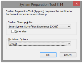

Sysprep can be used from command line (command prompt) or with graphical user interface. The GUI is very limited only allowing user to boot to Audit Mode, Welcome (OOBE) Mode and generalize the Windows setup by removing all hardware related information and drivers to allow Windows image to be moved or deployed to different hardware setup.
Sysprep GUI:
You can run it by typing %windir%\system32\sysprep\sysprep.exe to Run dialog (Win + R), or by browsing to folder C:\Windows\system32\sysprep\ and double clicking Sysprep icon. Be careful, though; if you do not want to do a Welcome (OOBE) boot as if the PC and Windows were totally new, close that dialog by clicking Cancel. Once you click OK there's no way to interrupt Sysprep.
Command line usage lets you use more options. To see the usage of sysprep command, type %windir%\system32\sysprep\sysprep /? to command prompt or Run dialog:

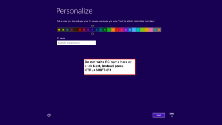

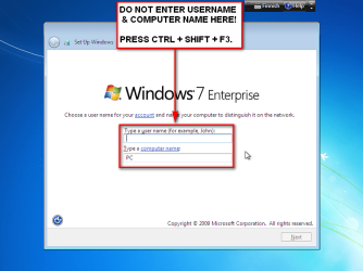

2.2. Enter Audit Mode
When installation after last reboot stops for user and computer name (Win 7) or Personalize page (Win 8), do not enter any information and do not click Next! We will now interrupt the last phase of Windows installation (Welcome (OOBE) boot) and reboot to Audit Mode. When we have sysprepped the image, installation automatically continues from here
Press CTRL + SHIFT + F3 when you see this window to reboot Windows to Audit Mode:

If you have got a new PC with pre-installed Windows, enter Audit Mode as told above when you see the respective Enter User and Computer Name or Personalize screens during the first time boot.
Windows reboots now and enters Audit Mode. As no user profiles are yet created it uses the built-in administrator account.

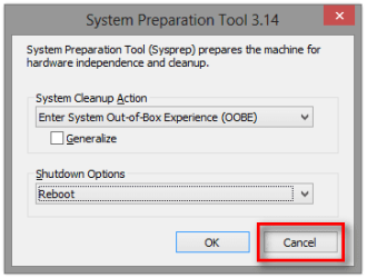

Before anything else close the Sysprep GUI by clicking Cancel:

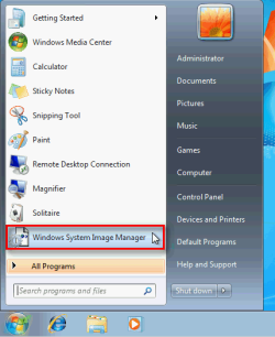

2.3. Install Windows System Image Manager
To create your first answer file you will need Windows System Image Manager (Windows SIM or simply SIM). Windows SIM is part of the Windows Automated Installation Kit (AIK) for Windows 7, and part of the Windows Assessment and Deployment Kit (ADK) for Windows 8.
Download respective AIK or ADK. You can use Internet totally normally in Audit Mode. Use the native built-in Internet Explorer for this download, do not install any third party browsers yet:
Of course you could have downloaded AIK or ADK already before you started the installation using another PC and now simply transfer the downloaded files to your new installation.
You can install AIK or ADK on any Windows computer to create answer files, it don't have to be done with the computer you are sysprepping. Install AIK on PC1, prepare an answer file, save it to a USB stick and use when sysprepping PC2.

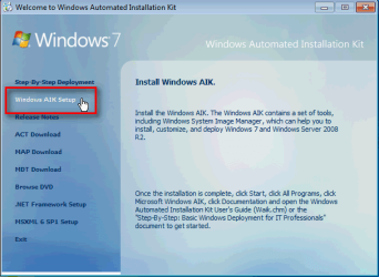

Windows 7 AIK is an ISO file. Burn it to a CD or USB and run setup application. Alternatively you can download and install a virtual drive application and mount the image on a virtual CD drive.

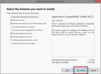

Windows 8 ADK is an executable install package, simply run it to start installation.
2.3.1. Install on Windows 7
If the autorun does not automatically run the setup launch it manually by double clicking the executable StartCD.exe on the WAIK CD.
Click Windows AIK Setup:
Accept all default settings, install WAIK. After installation you will find Windows SIM in Start Menu:
2.3.2. Install on Windows 8

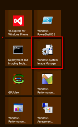

Run the downloaded ADK executable file. Click Install accepting default setup settings:
After installation you will find Windows SIM tile on Start Screen:

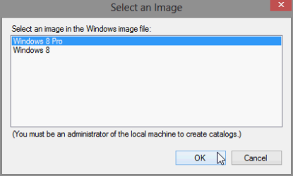

Browse to your Windows install media (DVD or USB), open the folder Source and select the file install.wim. Click Open:
Select the correct Windows edition according to the one you have installed:

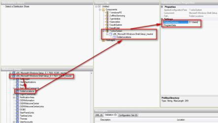

I will use Windows 7 Ultimate in this tutorial. I will create an image which does the following changes during Windows installation to various settings and variables:
  • Relocates the Main User Profile folder and all future user accounts including all user specific files and folders to drive D: from default location C:\Users to save space on system drive
  • Modifies the Default User Profile so that all accounts when created have desktop settings as I want to have them

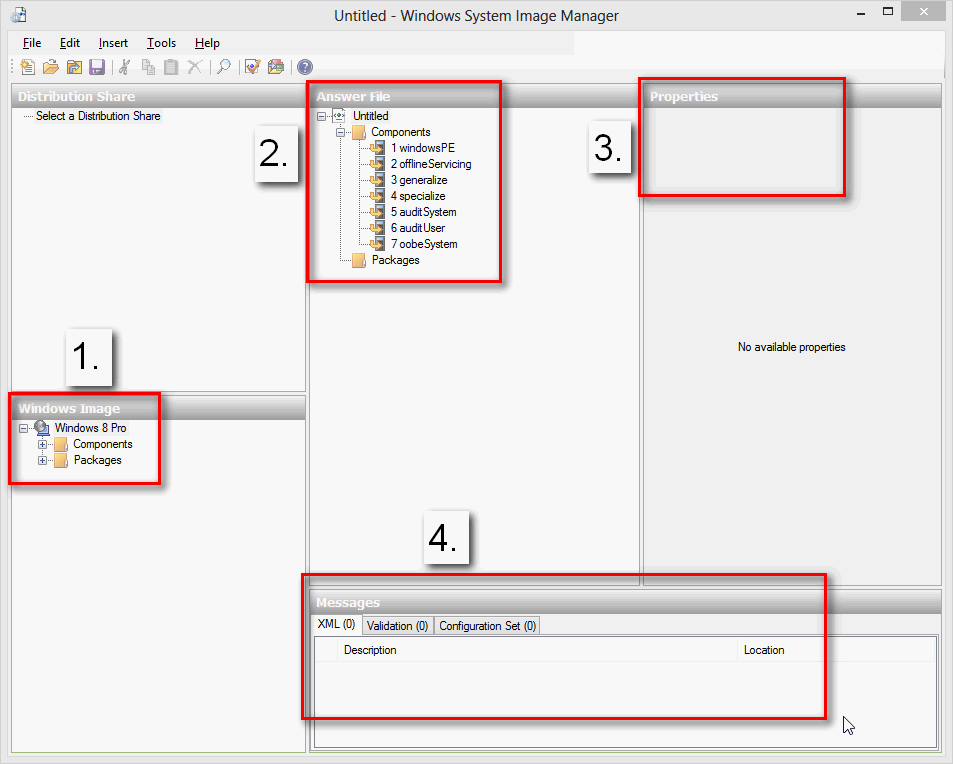

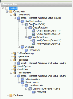

After you have created a new empty answer file you will see this:
  1. A list of Components and Packages for your selected Windows version and edition
  2. Content of the answer file, still empty
  3. Properties of selected answer file content
  4. System messages

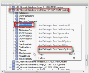

Click the + sign to open the Components list on Windows Image pane (#1. in screenshot above). We will start from the component group Microsoft Windows Shell Setup, most of the settings I wanted to modify can be found from this group.
Let's work in that order I listed my chosen modifications above. Click the + sign to open Microsoft Windows Shell Setup component group, right click FolderLocations:
You remember the table of different Component Passes earlier in this tutorial? As it explains, the oobeSystem pass is the one which will be done when Windows is started first time after installation. Logical place to change system variables is here, before the user gets control, so the pass 7 oobeSystem is only selectable here, all others being grayed out.
I select Add Setting to Pass 7 oobeSystem. Now the Answer File pane got its first content. As Microsoft does not recommend relocating other system folders than Users and ProgramData I will see those two folders here. Users folder is where all future user accounts will be stored, and ProgramData folder contains application settings for all users. As the Users folder can take a lot of space I want it located away from the system drive C:, so let's change the value (location) here. Default is C:\Users, I want to have D:\Users.
To edit or add a value first right click the component in Components list in Windows Image pane, select correct pass from context menu (for this component we selected Pass 7 oobeSystem), click the component name in Answer File pane, in this case FolderLOcations, click the subcomponent ProfilesDirectory in Properties pane and enter the value, in this case now D:\Users.

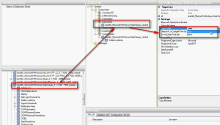

Next on my list of modifications is to copy Default User Profile settings. The Default User Profile in Windows is a reference profile; when a new user account is created it gets settings like desktop background and settings, IE favorites and home page, theme and default program shortcuts from this profile.
After we have created the answer file, we can modify the desktop and other settings while still in Audit Mode. These modifications will then be copied to Default User Profile when we finally sysprep.
To do this, we need to go back upwards a bit on components list and select the the main component Microsoft Windows Shell Setup, right click it and select Add Setting to pass 4 specialize. As you can see the Properties pane is now showing variable CopyProfile among othe things. This is the variable we need to set to True to copy our personalization settings to Default User Profile. As this variable only has two possible values, True and False (default), we do not have to type anything. Simply click the variable and select correct value from drop down list. We want it to be True:
   Note
Do not panic! There are literally hundreds of components and settings, you do not have to remember where each of them are and which component pass it belongs. The nice thing with Windows SIM and answer files is that you can keep trying and practicing. An answer file does nothing if it is not used in sysprepping so you can create as many practice answer files as you need to.
Keep clicking those components selecting different passes to see which values can be changed. Searching Internet for a component name usually gives you enough information to see what that component is for. Read this article to get to know the most important components: Walkthrough: Build a Simple Answer File

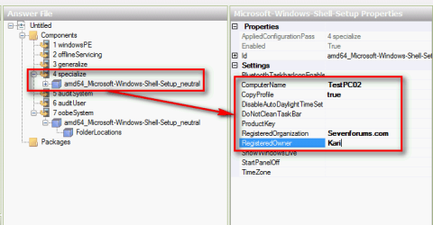

OK, let's move on. The next change on my list is giving the PC a name. Luckily it can also be found on Microsoft Windows Shell Setup as above the Default Profile, using the same pass 4 specialize so the only thing I need to do now is to click ComputerName variable in Properties pane and type the name for my PC. I also set Registered Organization and Registered Owner values as they are very practically also available here:

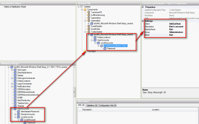

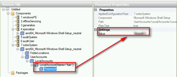

Next my personal main user account, next item on my wishlist. We are still staying in main component group Microsoft Windows Shell Setup, this time we will need component UserAccounts > LocalAccounts > LocalAccount:
That's done! Username Kari belonging to Administrators group. I also set password although it's blurred in this screenshot:

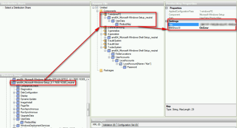

Last item on my wishlist is the Product Key. It belongs to Microsoft Windows Setup main component group. Open the main group, right click UserData > ProductKey component and select Add Setting to pass 1 windowsPE. Set the key:

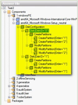

All partitioning components can be found in component group Microsoft Windows Setup > DiskConfiguration. We need one component for creating each partition and one component to modify each partition as follows (all settings in Pass 1 windowsPE):
Hard disk numbers start from 0, partition numbers from 1 therefore in this example C: = Disk 0 Partition 1, D: = Disk 0 Partition 2 and X: = Disk 1 Partition 1. Remembering this I need to browse to component group Microsoft-Windows-Setup > DiskConfiguration and start configuring. (Remember: all following components to Pass 1 windowsPE!)
First we create two disks and wipe them to be able to start from empty disks, Microsoft-Windows-Setup > DiskConfiguration > Disk, values to Pass 1 windowsPE
  • DiskID = 0
  • WillWipeDisk = true (this will erase the hard disk so partitions are created on an empty disk)
And the same for second hard disk:
  • DiskID = 1
Next we create first partition on first disk. Component Microsoft-Windows-Setup > DiskConfiguration > Disk > CreatePartitions > CreatePartition, values to Pass 1 windowsPE
  • Extend = false
  • Order = 1
  • Size = 250000 (size in Megabytes)
  • Type = Primary
And second partition, component Microsoft-Windows-Setup > DiskConfiguration > Disk > CreatePartitions > CreatePartition, values to Pass 1 windowsPE
  • Extend = false
  • Order = 2
  • Size = 250000
  • Type = Primary
Finally the third, Data partition, first partition on second disk. Component Microsoft-Windows-Setup > DiskConfiguration > Disk > CreatePartitions > CreatePartition, values to Pass 1 windowsPE
  • Extend = false
  • Order = 1 (first partition of second HD)
  • Size = 500000
  • Type = Primary
Now we need to edit those three raw partitions. First C:
Microsoft-Windows-Setup > DiskConfiguration > Disk > ModifyPartitions > ModifyPartition, values to Pass 1 windowsPE:
  • Active = true
  • Extend = false
  • Format = NTFS
  • Label = OS (any name you want to give to your system partition)
  • Letter = C
  • Order = 1
  • PartitionID = 1
The D: partition:
  • Active = false (only one partition can be active)
  • Extend = false
  • Format = NTFS
  • Label = UserProfiles (any name you want to)
  • Letter = D
  • Order = 2
  • PartitionID = 2
Last but not least the data partition X:
  • Active = false
  • Extend = false
  • Format = NTFS
  • Label = Data
  • Letter = X
  • Order = 1
  • PartitionID = 1
These components with correct values would then create our two disk three partition system when Windows would be installed using our sysprepped image.

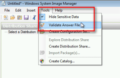

2.5. Review and Validate your Answer File
Time to check we didn't forget something. The Answer File pane shows your content, small + sign in the component box before its name tells that component has modified (non-default) values:
When you are satisfied, you need to validate the answer file. Select Validate Answer File in Tools menu:
If validation finds errors it shows them on Messages pane. Check the components that produced error messages and try to fix errors. In our case now everything seems OK:
Now save the answer file, name it as you wish. Extension must be xml. The file can of course be saved anywhere you want to but when used with Sysprep it must be on root of a removable media, USB, CD, floppy or such.
I save this answer file as MyAnswerFile.xml on a USB Flash Stick, drive F:.
I am used to do one extra check at this point: I open the answer file from where I saved it with IE and read it through to see if my eyes can catch a typo. You can open XML files with IE and open & edit with Notepad if you want to see results of your hard work yourself. If not, here's an example, the answer file we created together:
<?xml version="1.0" encoding="utf-8"?>
<unattend xmlns="urn:schemas-microsoft-com:unattend">
    <settings pass="oobeSystem">
        <component name="Microsoft-Windows-Shell-Setup" processorArchitecture="amd64" publicKeyToken="31bf3856ad364e35" language="neutral" versionScope="nonSxS" xmlns:wcm="http://schemas.microsoft.com/WMIConfig/2002/State" xmlns:xsi="http://www.w3.org/2001/XMLSchema-instance">
            <FolderLocations>
                <ProfilesDirectory>D:\Users</ProfilesDirectory>
            </FolderLocations>

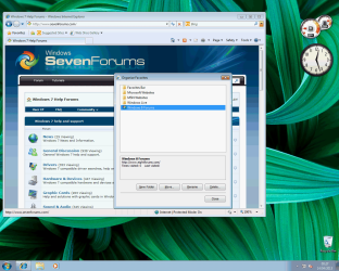

Before proceeding I need to create a partition D: using Disk Management (see tutorial); as you remember I changed the value of the component ProfilesDirectory to a yet non-existing partition D:. Creating it now will save me a lot of problems, sysprepping would have stopped for an error if it hadn't found the partition needed.
I also change some desktop settings like wallpaper and theme, create shortcuts and install a few gadgets, also I will set IE home page to Seven Forums and save Windows 8 Forums to Favorites. All these modifications will be copied to Default User Profile with CopyProfile component we used above so each and every user account that will be created on this Windows will have the wallpaper, icons and shortcuts, gadgets, home page and favorites as I want to have them.

Now the sysprep command. Sysprep get's the instructions from various switches. In this case we need four switches to tell Sysprep what to do:
  • Generalize
    • The CopyProfile component we used does not work without generalizing, removing all hardware related information. This is not a problem for us, our Windows is freshly installed and hardware specific drivers will first be installed when we do the OOBE boot
  • OOBE
    • This switch tells Sysprep to prepare computer for a Welcome (OOBE) mode boot i.e. first time boot. The other alternative here is Audit, to boot to Audit Mode but as we are finishing here and want to continue installing Windows, OOBE is our choice
  • Reboot
    • We ask Sysprep to reboot after it has finished. Other alternatives here are Shutdown which is practical if you want to sysprep then capture the image to be moved to another computer, and Quit, asking Sysprep to keep Windows on and stay in Audit Mode after sysprepping
  • Unattend
    • This switch tells Sysprep we want to use an answer file. To tell which answer file, add a colon after switch name Unattend, then the full path to answer file. Remember that if the answer file path contains any spaces you must put it in between quotation marks. Path F:\MyAnswerFile.xml does not need quotation marks but path "F:\My Answer File.xml" does
A switch is separated from the command with a slash sign (/).
Our command for now is:
sysprep.exe /generalize /oobe /reboot /unattend:F:\MyAnswerFile.xml
Type the command and Hit Enter. You will see that Sysprep is working:

Finally there! As our CopyProfile component has told Windows, all user accounts get the walpaper, gadgets, theme, shortcuts, colors etc. from the new Default Profile. IE has also got a new default home page, every new user account has Seven Forums as home page and Eight Forums in Favorites as the CopyProfile component copied all changes made to built-in administrator account to Default User Profile:
