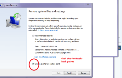

Long story short, crappy 2009 asus crashes. Prior to crash screen constantly froze accompanied by a buzzing sound from the speakers. After crash laptop blackscreened, and after a second reboot met with screen with some americorp title an at the end reads cmos checking bad. I set time and date, and then upon third reboot am met with screen that read two options: run windows repair(recommended) or start windows normally. I try star windows normally and enter the login screen, but everything is enlarged, as if in safe-mode, login prompt never comes up. Reboot for 4th time, this time choosing run windows repair. Unfortunately i dont have any system images or restore discs or anything.
So my questions:
1. Is this fixable-as in can i restore the computer to where it was before the crash?
2. Can i recover the hard-drive info; i have lot's of music and stuff i would like to keep.
3. What the heck happened????
Asus
Hello and welcome Cheesemaon yes mate just go to safe mode then system restore and pick the date way back as you want see pic.

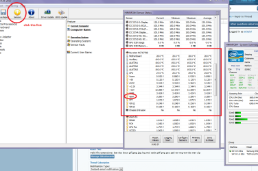

Plus you could check the CMOS battery volts too with HE Info HWiNFO, HWiNFO32/64 - Download > pick the right bit version and see pic how it comes up.

Yep I had only a little info to go on so suggested the restore a that what the OP was asking otherwise I might have suggested a factory restore and the CMOS was mentioned so suggested the battery.
My other thought was going to be to test the hard drive as it is getting a little long in the tooth and also look at the temps but no matter he can try those.

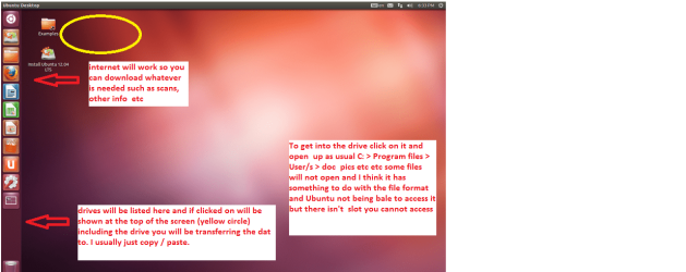

Sorry late reply if you cannot boot from the USB then I use this and I might add that WHS's stuff is really good but if for any reason it will not boot from a USB port then do the below.
BOOTABLE UBUNTU
Make a bootable Ubuntu disk http://www.ubuntu.com/download
Set the BIOS to boot from theoptical when the machine boots it will show you a screen with TRY or INSTALL> select TRYnot INSTALL
When it is finished - it takes verylittle time you will get a screen like in the pic .
Open the drive you want > Userand dig down until you get to the data / settings you may be able to copy /paste the material you want to an external source or other installed drive doingthis.
I am not sure if it will but I haverecovered tons of data etc using this method both on "dead" or justplain drives that you cannot get data from using Windows.
