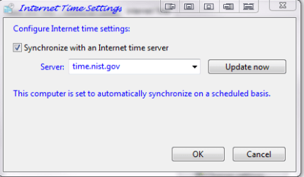

ah im not alone with this, i am going to try and set the same time server for windows and kubuntu example>> time.nist.gov

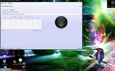

kubuntu has the same as windows to change time but the time servers to choose from are not the same
