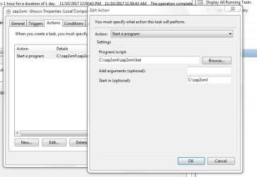

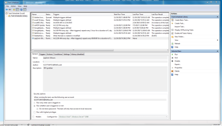

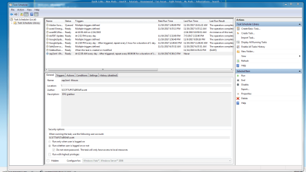

included some pics, you can see it has never run, when I select run, it never completes, simply says running forever?
I changed to only run when user is logged on.
I changed permissions on the file to everyone full control.
I get a different response, a flash of a command prompt, then it says runnning forever it says running till I end it.
Get error on description line of 0x2331

I actually SOLVED this in win7, which should be same as win 10.
Even though this setting 'start in' says 'optional', you MUST entire the directory, cant leave it blank.
It runs everytime now I test run this.
