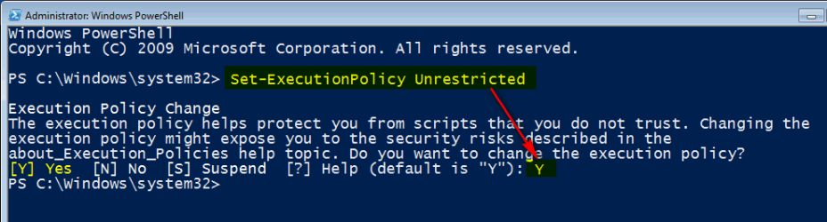

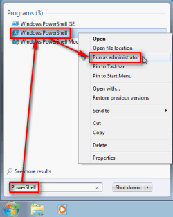

2. Change PowerShell Script Execution Policy:
Before running the script you have to change the PowerShell Execution Policy. This must be done only once, any change in policy will be active until the next time you decide to change it. By default the policy is set to Restricted, meaning no scripts are allowed to run.
To do this run PowerShell elevated (as administrator) and change the policy as told here:
  • Click Start
  • Type PowerShell to Start Menu Search field
  • Right click PowerShell
  • Select Run as administrator
  • Accept the UAC prompt by clicking Yes
  • Type the following command to PowerShell, press Enter:
    Set-ExecutionPolicy Unrestricted
  • Accept the policy change by typing Y, press Enter
The policy is now changed, you can close the elevated PowerShell window and continue from below.

I just tried to launch it but got error, checked and it says "use of script is disabled on this system". Also .PS1 extension is by another app (PSXMemTool) but i guess that's not important. There's something i'm not sure of still though : When you launch this script, it'll automatically launch both of the apps and close the one of your choice in the end, right?
If so that means i would have to create a script for each games? That's not what i asked first. I wanted a script to run all the time, monitoring all process, so as soon as it detect i launched one of the exe from a list (games), it'll launch CPU Throttle, and when closing a game from that list, close CPU Throttle. But maybe that's not possible..? I have no knowledge for those things. You tell me. Thanks!
Win7x64
Right.
I forgot to mention that scripts must first be enabled. As I always enable the PowerShell scripts I simply forgot the whole thing.

OK, the original post is now more like a mini tutorial, it is edited to cover everything you need to know to enable PowerShell scripts and create a script that launches multiple programs and closes them all when the last program launched by the script is manually closed.
