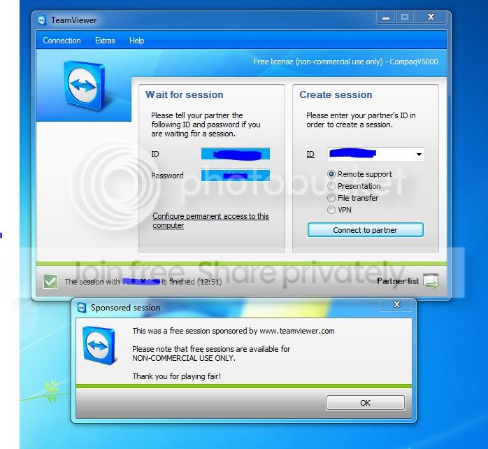

The Connection screen will show you two panels when connected to the internet. The left side panel
shows your waiting for session ID ( usually a 9 digit code ) and a password code. These are what you
provide to your connection partner to allow them to access YOUR computer. A new password code will be
generated each time you end Team Viewer & exit it, & then run it again. This is for security purposes.
The right side panel is for you to connect to a partner's computer. They provide you with their ID &
password codes for easy connection.

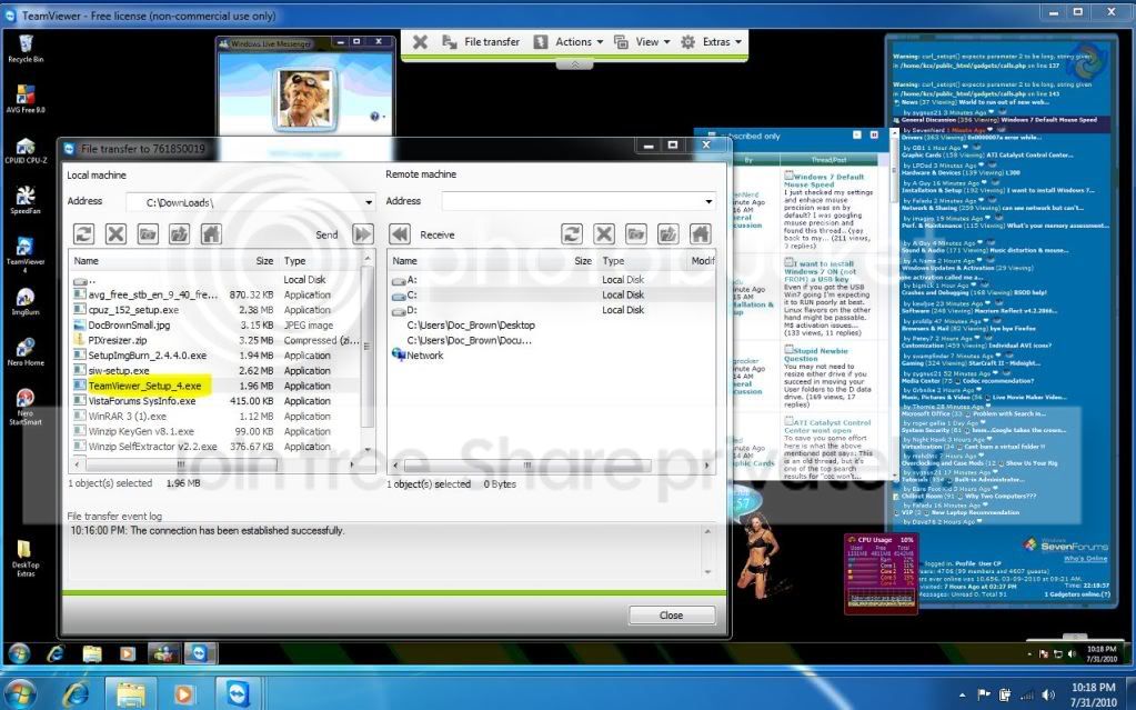

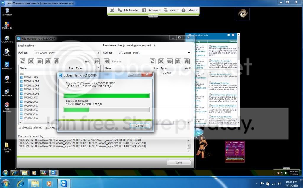

The File Transfer window lets you transfer files back & forth between both computers.

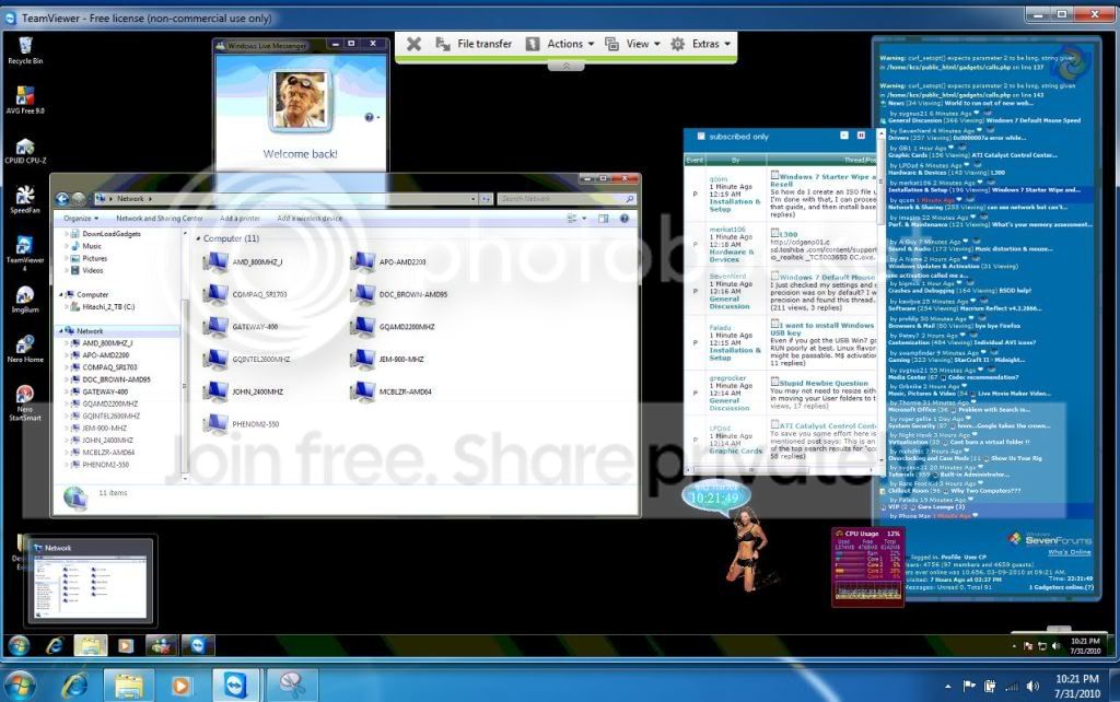

If the remote computer is connected to other computers on a network, it is possible to access certain HD's
and folders that have sharing permissions. By using Windows Explorer on the remote computer.
You can even browse the internet with the browser on the remote computer.
