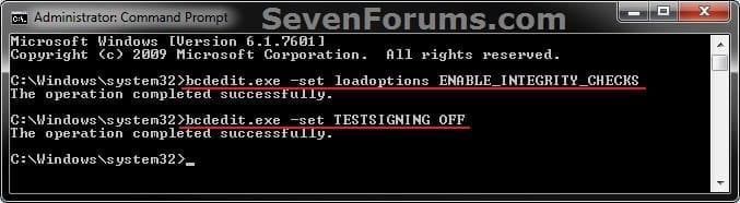

1. Open an elevated command prompt.
2. In the elevated command prompt, copy and paste the command below and press Enter. (see screenshot below step 3)
bcdedit.exe -set loadoptions ENABLE_INTEGRITY_CHECKS
3. In the elevated command prompt, copy and paste the command you want to use below, and press Enter. (see screenshot below)
(Turn Off test mode and remove watermark)
bcdedit.exe -set TESTSIGNING OFF
OR
(Turn On test mode and add watermark)
bcdedit.exe -set TESTSIGNING ON
4. Close the elevated command prompt.
5. Restart the computer to apply.
