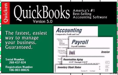

FWIW: I installed the diskette install version of quickbooks version 5 on my XP under virtual pc.
Rich
