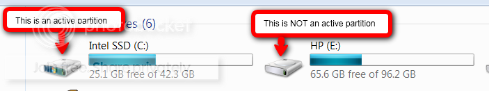

When you install Win7, you usually get an extra partition of 100MB (sometimes 200MB) that contains the master boot record and that is designated as active. That partition is hidden and you have to check that in Disk Management. If such a 100MB partition exists, you have to do as I said above because your C is not the active partition. If, however, you install e.g. from an OEM 32bit installation disk, you may not have this 100MB partition and the MBR is on C in this case. Then you have to mark C as active and restore the MBR (as I said for XP).
You can also make a quick check in Computer. If your C has the little shield in the front of the disk icon (in Tiles view), then it is active. See picture:

No, just leave the little partition alone. It is hidden anyhow (has no drive letter), so you will not see it other than in Disk Mangement. The MBR will stay there and since the MBR is "universal", there is no need to replace it.
Now if one day that little partition gets mucked up or you have to install on a new disk because the old one was defunct, that is another story. Then you have to create an MBR in C. But we'll cross that bridge when the case occurs.
But maybe you are lucky and your installation disk does not create the little partition (which is really only for the MBR and for the bitlocker in Ultimate). In that case, everything would be "business as usual". Sorry that this is all confusing, but they make it ever more complex.
