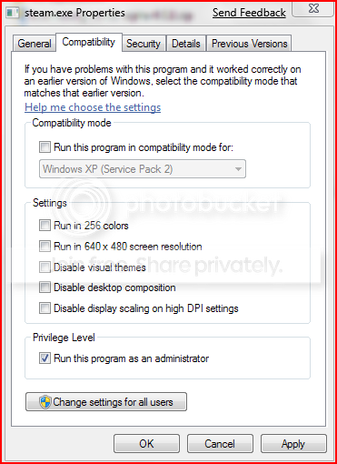

Yes i have/had run as admin on.
As for the explorer thing i didnt know that and will give it a go, but i tried to set my entire C drive as full control, but i got so many "Access denied" due to permissions i just clicked abort lol. But i'll give the explorer a go :)

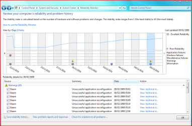

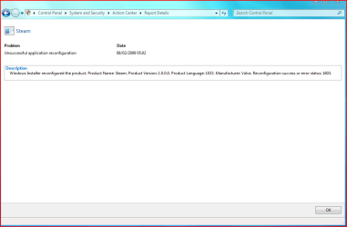

Tried a few times now, no go!
