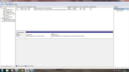

Your slow boot is probably caused by the remaining Grub. But that can be fixed. Post a picture of your Disk Management and we'll see what can be done.

1st thanks for the effort youre making mate!!!!
here is the pic, but since I am at the mo working in Germany ist all in German...

Kein Problem. Deutsch ist meine Muttersprache.
You were lucky. The Grub does not seem to be in your system. But now I am a bit puzzled about your slow boot times. I do not see a partition where you could have possibly installed Ubuntu. What happened to that partition?
gut zu wissen....
The onlything I did was to go into the add and remove programs through the C/P and deleted ubuntu...I did think at the time that this will only superficially remove it but didnt think that it would create damage.

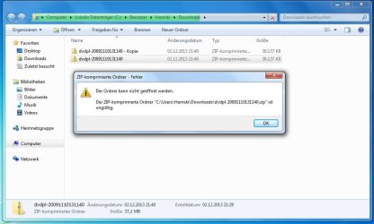

I did it all. 1st I tried to d/load the dvd driver from toshiba but everytime came as a corrupted file, then I tried to D/load a new bios, that was the same, so finally i formatted my usb stick through CMD via the link you provided and succeeded in reinstalling win 7.
Now the computer starts up like lightning and all is working........except...... the DVD/CD is not detected and not visible under my computer!!!!!
i dont know really, im now going to retry the driver now that i have a fresh healthy copy installed, any ideas welcome.:o
thanx
"EDIT"
here is the latest try, with the new copy of 7, the driver is from toshibas website for this exact machine

Did you try to open it with 7-zip.
no, is that in the zubehör?

ves now I have tried it with 7zip, no success!

Remind me - from where did that zip folder come.
from Toshibas Website under Downloads

Is that a 'RAR' folder by chance. Check in Properties.
wow whatdya know, a few days ago the pc went thru 178 updates and 5 automatic restarts. I didnt think much of it, infact i was annoyed cos the pc was unusable for a good hour.... yesterday as i was looking for something I clicked on my computer and what dya know, the DVD icon was ther and it functions einwandfrei as they say in your language WHS.
Ich danke dir für die aufwand und deine hilfe... looks like windows took its time and looked for solutions at microsofts site... not bad microsoft....
